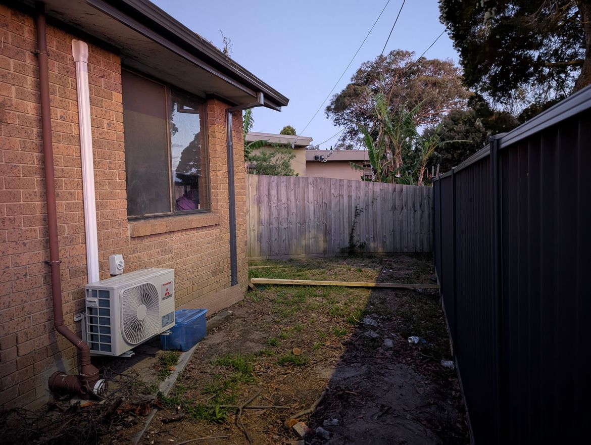

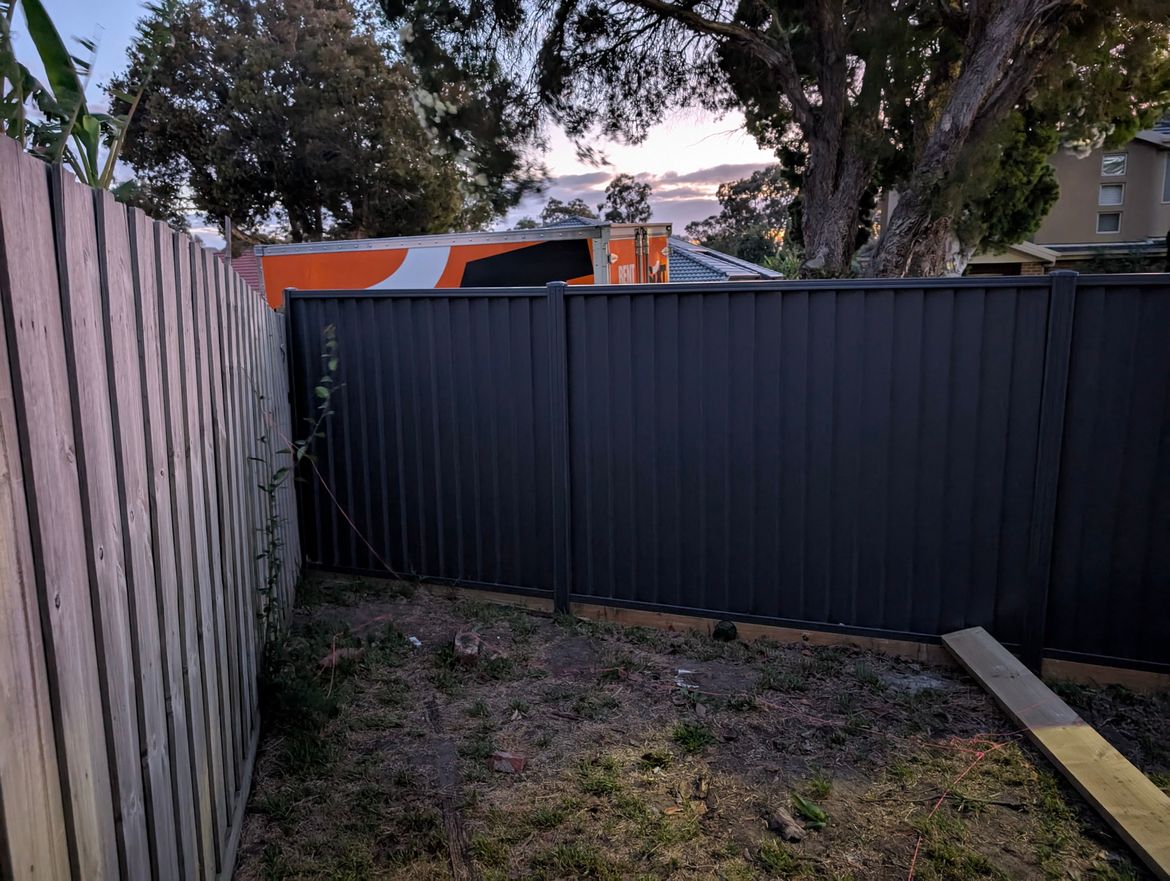

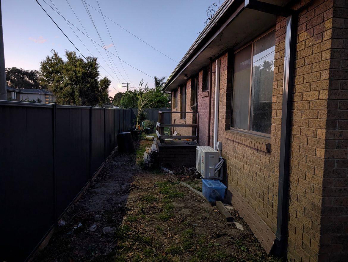

Thanks @EricL for the simplified solution. I realized i made a typo on the dimensions as it is actually 10m x 5m and it is along the house. I have attached some photos to give it more context.Front View where a door will be placedhardstand area which will have netting over itproposed undercover area for the cats to relax when it rainsView from the end of the cat enclosure
hi @Dave-1 Thanks for your comments and ideas. I am sorry i made an error in the dimensions and should have been 10M x 5M and not 10mx10m.
I like your idea of timber along the top of the colourbond fence. The isssue is that the channels used are flimsey so will look at putting in some 90x45 posts with a timber running on the top to act as an anchor for the netting.
My issues currently are;
1. The design - How big a post do i use?
2. What fixtures do i need for the cat netting onto the timber and the facia board?
3. How do i make it tight so it looks neat and professional? (avoiding putting posts in the middle as the client wants open space she can chill with her furry friends
4. What design for the undercover area approx 5x5 triangle)
Thanks
BenK

To go through your issues -
Depending on how many you wnat to use, 90 *90mm posts would be ok. (tho really for the 5m span I am not worried about the fence moving, especially with the timber strip idea which id still suggest to use.
Coolaroo Green Timber Fasteners - 50 Pack or Coolaroo Shell Timber Fasteners - 50 Pack
3. How do i make it tight so it looks neat and professional? (avoiding putting posts in the middle as the client wants open space she can chill with her furry friends.
I would start by tacking the net for an area (only partially putting the clips into the timber) and getting the right tightness across the span. Then go back and put more tacks in to secure the holes between the few ones to start with. (one every 2m along the fence and facia) I would probarly suggest to do opposing corners (like how you tighten wheel nuts) and that will give you less chance of looking like one section is too tight. also you could use the timber strip say for the facia and on the ground roll the timber over the material and fasten it on the side that will go towards the facia, that way you will have a consistant tension and the mess will be hidden. You could do it both sides of the house and fence but suspect the fence side would be hard to roll and clamp 🙂
Same process as step 3, id choose the 2 widest parts and "tack" the cloth and then work back towards the pointed end. You have facia on the house tho high, and I would bolt a piece of H2 timber to the brick wall. Then you could do the same with a timber strip over it if you wanted or just stay with the green fasteners.
