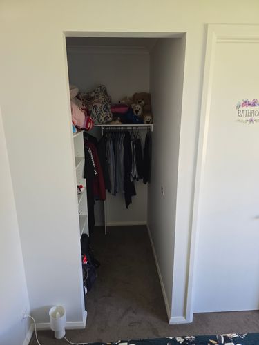

How to Put door on walk in wardrobe if no frame? please give me advice in detail.
Welcome to the Bunnings Workshop community @AnilSharma. It's sensational to have you join us, and many thanks for your question about installing a door.If your walk-in wardrobe doesn't have a frame, installing a door can still be a relatively straightforward task.
The first step involves installing a door jamb, which is the frame that holds the door in place. This provides the necessary structure and secure points for the door hinges. Once the jamb is in place, you can hang the door by attaching it with hinges, ensuring it swings properly, aligns with the jamb, and opens and closes smoothly.
Finally, you'll install the door handle and it might be an idea to install a door stop to prevent the door from swinging too far. Seal any gaps for a polished finish.
If you're not experienced with carpentry, it's a good idea to hire a professional. You might consider using services like Hipages or Airtasker, where you can find a local carpenter who can handle the job efficiently, and they can also assist with selecting the right door and materials for your space.
If you want to attempt this as a D.I.Y. project, here are some helpful guides: How to install a door jamb, How to hang a door and How to install a door handle.Please let me know if you have any questions.Mitchell
