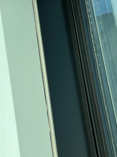

The caulking/sealant has a lot of gaps/has come off the window frame in a lot of places in my apartment.
Any suggestions for a fix?
pictures attached.

Welcome to the Bunnings Workshop community. It's sensational to have you join us, and thanks for sharing your question about fixing the caulking gaps in your window.
It appears your current caulking has lifted and is no longer providing an effective seal, I suggest removing the old seal with a CornerTape Professional Silicon Remover and applying a new sealant. I recommend using Selleys 475g No More Gaps Interior Multipurpose Gap Filler.
Here is a handy step-by-step guide: How to repair a cracked cornice (the application technique can be used for your window frame as well)
