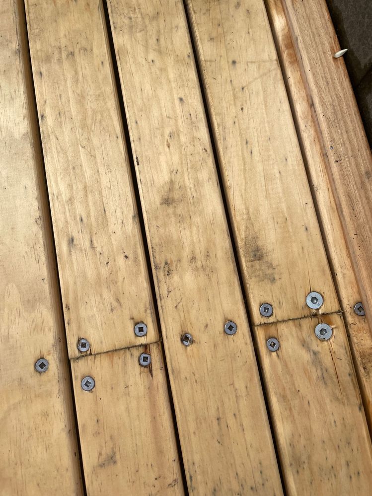

I've just had a new deck installed with treated pine. I was about to oil it but I've noticed these black spots appear on a number of boards. Does anyone know what this is and how to fix it? Many thanks.

How long have the panels been installed on your decking frame? These appear to be tannin oxidation reaction (also iron-tannin reaction). This is a natural reaction that occurs when wood comes into contact with base metals such as iron. The tannins in the wood oxidize and cause discolouration. I suggest using Cabot's 1L Deck Clean to clean the surface of the deck before you oil the surface.
