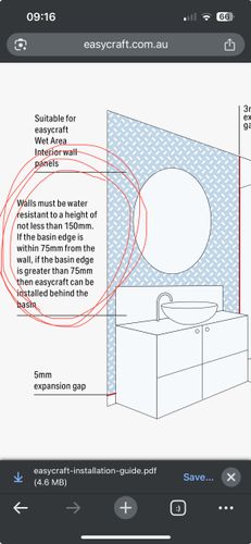

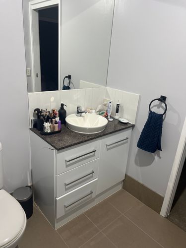

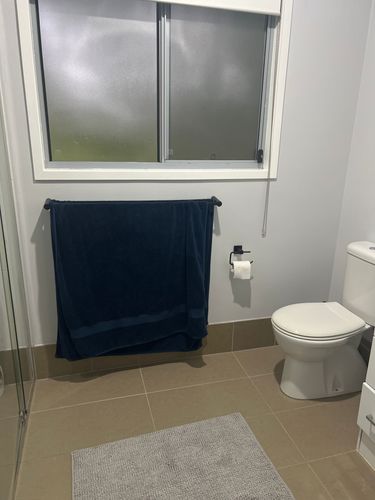

My partner and I are planning to use wet area VJ board for our bathroom/laundry reno. So far we are down to a stud wall with the walls straightened ready for sheeting.
Is any type of additional waterproofing system required where the panel meets floor tile? Also how do you finish the wall and floor tile junction? Is it just a piece of channel for the sheet to slide into or do you a small gap between the wall panel and floor tile? Or is it something else?
