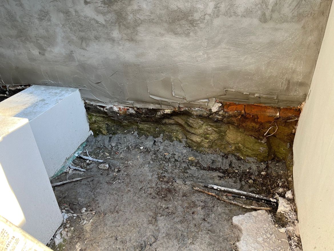

I need to lay a single skin row of bricks up against sandstone that appears damp. The bricks will be rendered but I want to ensure the moisture from the sandstone doesn't end up through the bricks / render over time. Will this product Crommelin 2L Dampstop work if I apply it over the sandstone prior to laying the brick? We are probably looking at an area of a couple of square metres. I was thinking to lay the brick and fill in the small gap with cement. There wont be a lot of room to apply the Crommelin 2L Dampstop to the brick once laid so was hoping apply it to the sandstone before bricking and filling would do the job. Can you assist?
The landscaper had arranged to have the brick wall above the sandstone rendered but didn't know the sandstone would remain exposed. A single skin of brick will cover the sandstone and blend in with the other block work but the sandstone is always wet and I don't want this coming through the brick / render over time
