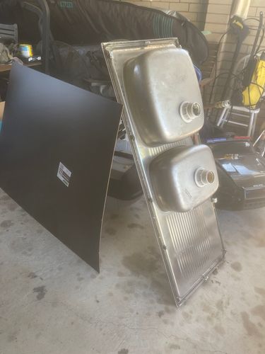

Hi I plan on making a kids mud kitchen with this old sink. Are you able to please advise what connections I need to connect the water tap to a garden hose?

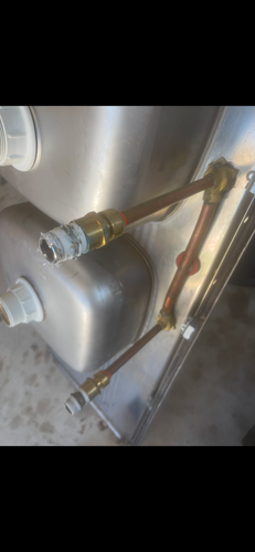

In order to get the plumbing working again, I suggest using a Brasshards 15mm Brass Threaded Cap on the hot side fitting. For the cold side, I recommend using Brasshards 20 x 15mm Brass Threaded Hex Reducing Bush. This will allow you to connect a Pope 12mm Universal Tap Adaptor or similar, which will then allow you to plug in your garden hose.
Just remember to put a catch bucket under the sink so that your kitchen cabinet does not get overly wet.
