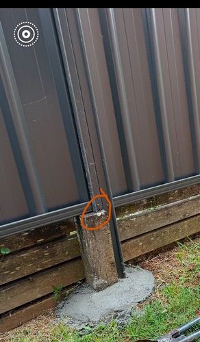

i had a fencing company install a new colourbond fence to an investment property and they are adamant they have done it correctly…

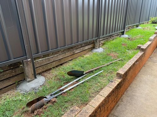

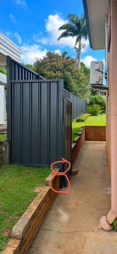

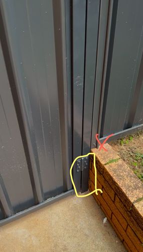

as per pictures they have installed some of the fence posts ontop and into existing timber posts used for an existing retaining wall. I’m not a fencer but I assume using the timber posts is not structurally sound and all the posts need to be 600 or 800mm in ground and concreted?
I will speak to them again but assume this all needs to be ripped out, and maybe reinstalled in front of the wall and directly into the ground and concreted?
