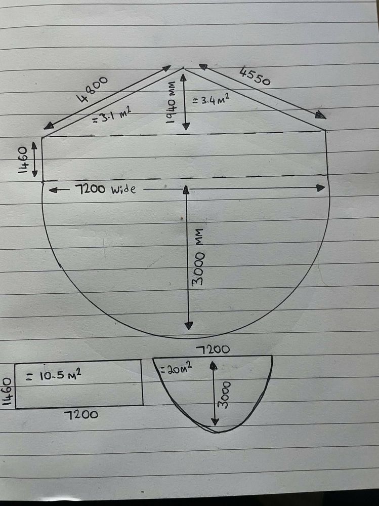

Hey Guys, I'm struggling to measure this odd shaped garden i have to Mulch at 100mm thick.
I've broken it down to 4 shapes to make it easier but i'm second guessing myself on my maths.
Left Hand Triangle = 3.1m2
Right Hand Triangle = 3.4m2
Rectangle = 10.5m2
Semi Circle = 20m2
Total Surface Area = 37m2
At 100mm Thick should equal = 3.70m3
Does this look Correct
Appreciate Any Help.
