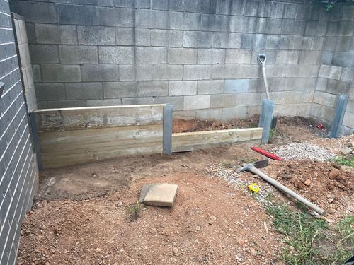

I have a fence made from besser blocks. It’s an eye sore and I was hoping to make it kid friendly by adding a chalkboard. What materials do I need? Are their weatherproof chalkboard panels I could use or is paint better?
