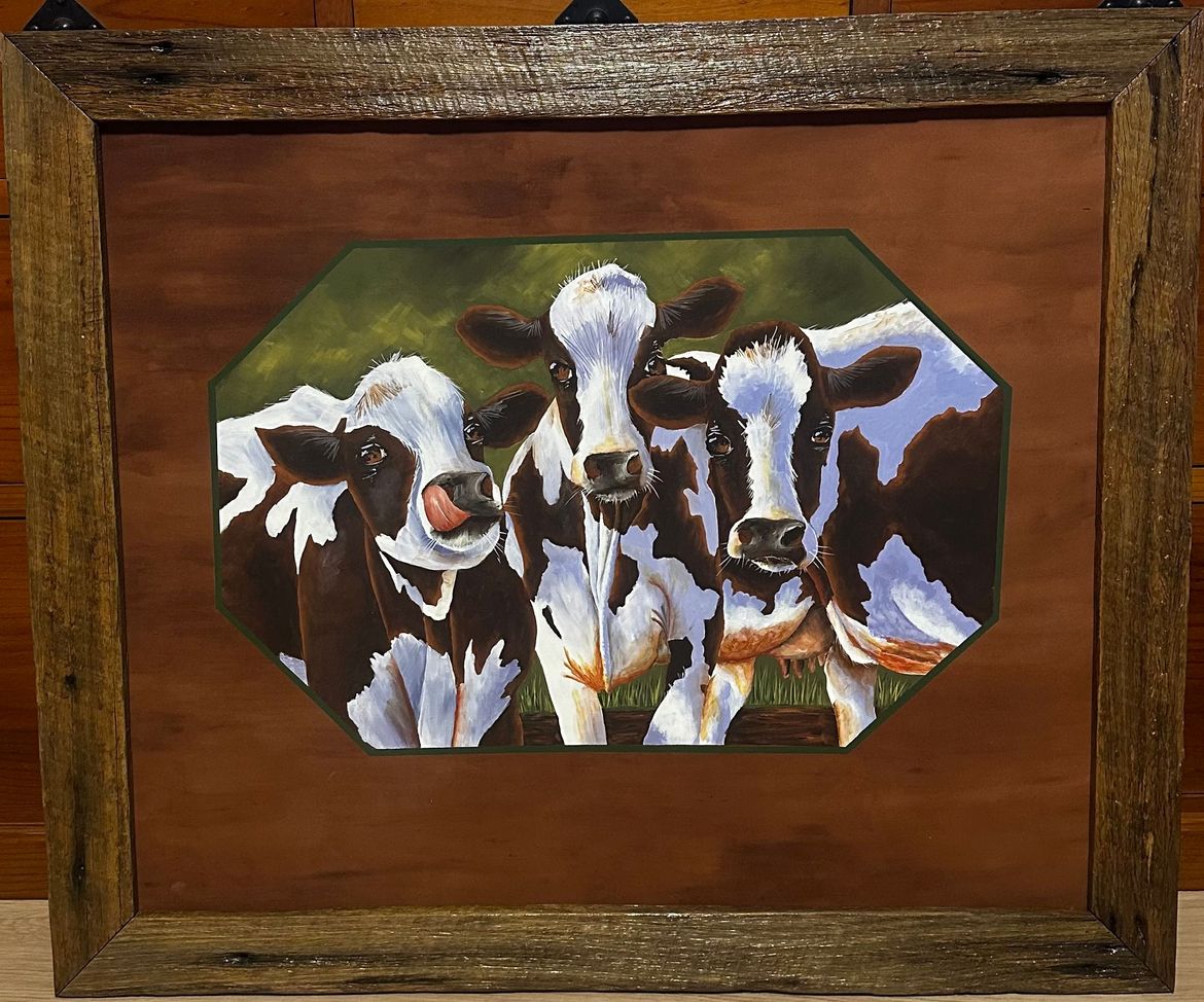

Chez made this painting a while back and has suggested many times how good it would look with an old fence paling style frame. With Valentine’s Day approaching seems no better time to make it happen.

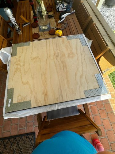

Mount picture to plywood.

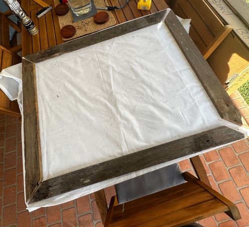

Clamp paling components face down to bench & measure diagonally to make square.
Position plywood on back of palings & clamp down.
Fit joining hardware to back of frame/plywood.
