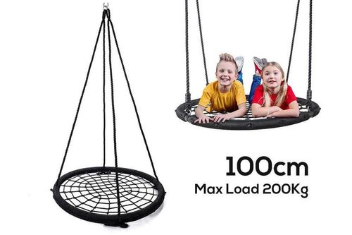

Hi community, I have a 100cm round net swing ready for install minus the attachment needed for the ceiling. I'd like to install attachments in the living area as well as outside underneath our level 2 bedroom. The 2x ceiling attachments will allow us to attach the net swing indoor or outdoor depending on the weather. However, I'd prefer an attachment that only moves forward and backwards (no sideways movement) - the net swing has two ropes on either side of the swing to cater for this. The project is for our autistic child (roughly 40kgs). He doesn't sleep at night and has a severe noise sensitivity so we can't always get him to the park to meet this particular sensory seeking need. Any help with how to install the swing and what attachment is best would be greatly appreciated. Thank you.
