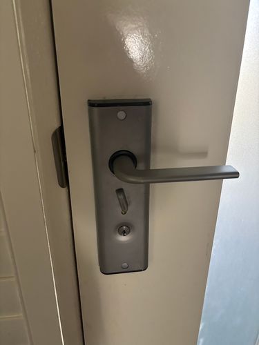

I am trying to change lock for my house main door and the lock secure cap is not coming out any idea how to uninstall the lock in the picture it’s from nexion brand

The only way to uninstall the lock is to remove the screw caps and unscrew the lock.
Have you tried using a thin tool like a flathead screwdriver to pry the caps out?
Maybe spraying them with WD40 will help loosen the screw caps.
You could also try putting a piece of double-sided tape on the screw caps and then attaching something to the tape so you can pull it out of the hole.
Unfortunately, without damaging the lock or the door, getting the screw caps out is the only way you'll be able to get the lock out.
