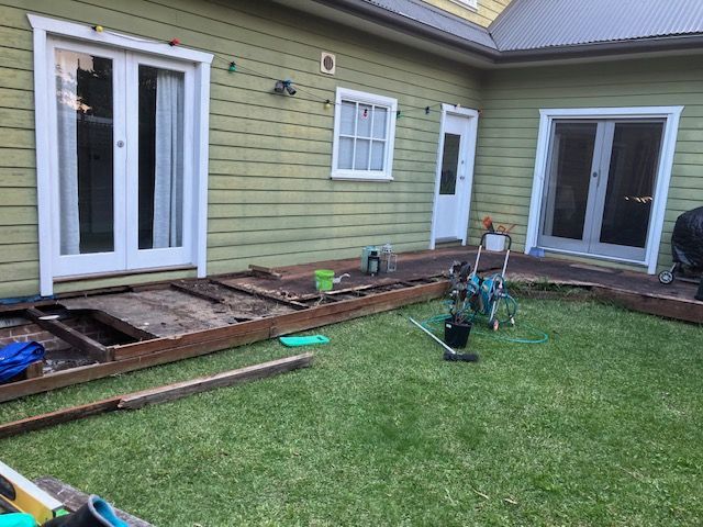

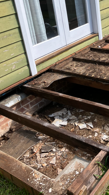

Hello. I am in the process of repairing/replacing my deck due to rotting joists. Upon removal of some decking boards, I noticed that the original joist construction involves 100 x 50 joists with a sheet of gyprock/villa board??, then a 50 x 50 joist on top. This has resulted over time of debris and water building up around the smaller joists and causing rot. I am guessing the original builder has laid this gyprock in order to slow down rainwater drenching under the house and possibly flooding the garage during heavy rain. I am mindful that a low-lying deck should have ventilation, and it seems to me that this gyprock is preventing this and obviously catching not only water but debris, causing the rotting of the joists. I am of a mind not to replace this gyprock ( if that is what it is??). Any ideas? Cheers...Darryl
