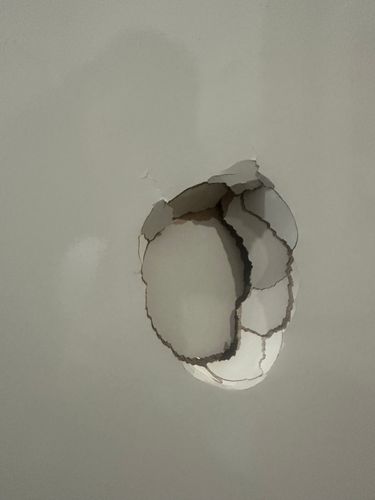

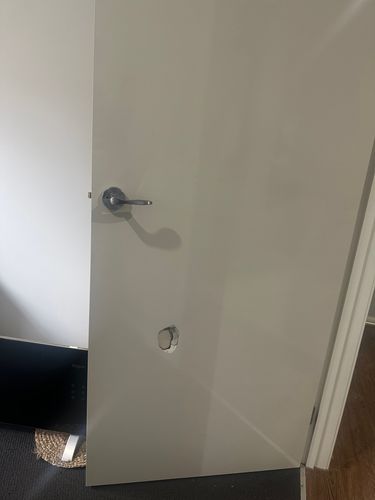

How do I fix this dent?

You'll find plenty of great advice in those discussions. I'd encourage you to consider whether you can repair the current door satisfactorily or if replacing the whole door would be worthwhile. Internal doors are quite budget-friendly, so it might be an easier option to swap the door.
The general steps to repair the current door is to remove any loose and broken pieces of the door skin and fill the hole with Builder's Bog. You'll then be able to sand it back flush with the door's surface, before priming and painting the door.
