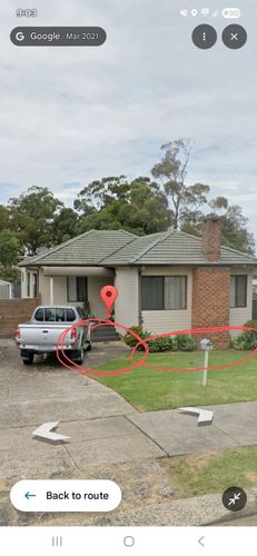

Hi, Im currently having issues with my brick piers sinking. Before fixing them, I need to fix the root cause of the issue which is water pooling in the front section of the house on the drive way.

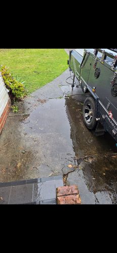

I have circled in red where the water comes from and ill attach photos of where it ends up. The path it takes it from the front left to the right rear of the property. All downpipes are fine and charged system to the rain water tank and no street drainage. This is my issue as all the down pipes are charged and connected to the rainwater tank.
I do have a stormwater pipe running to the rear of the property on the left side of the house next the gate. I would like to connect to that and let the water run to the rear of the property. I just needing a solution for the water to get to that section and stop it traveling under the front brick work and washing the piers.

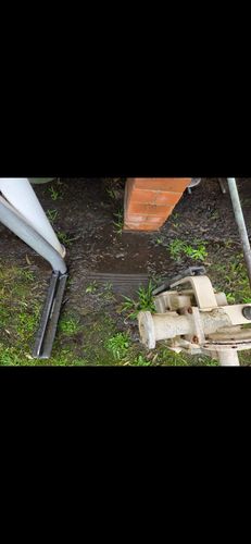

This is where the water ends up pooling once washed from the front.
