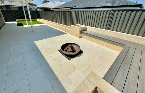

I'm looking to build similar to this limestone block planter box and bench seat.
Blocks used with be 500mm x 350mm x 200mm reconstituted limestone.
I have built similar before in the same block size on compacted sand, with the first course approx 200mm under ground and it's had no issues for over a year.
My question is regarding footings.
I have seen companies lay on compacted yellow sand at ground level.
I have also seen people use compacted cracker dust as a footing.
My preference would be a 300mm wide x 100mm deep reinforced concrete strip footing, however I am wondering if this is overkill?
Any advice is greatly welcome.
