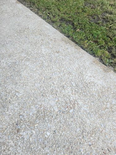

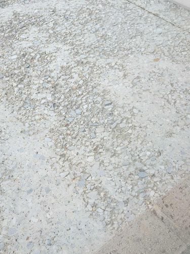

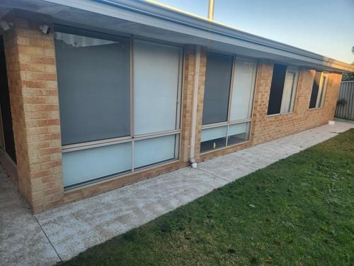

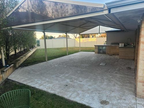

Long story short, we moved into this property with a large concrete area however the exposed agg must be quite worn as it was very sharp to walk on and my kids would cut themselves badly if they tripped. We had it honed back but unfortunately it came up very patchy and we were told it was due to the age of the concrete and the high ratio of rocks vs cement (see images). Sadly with that money down the drain we need to find another option to resurface it. We're considering tiling it but after seeing the labour costs we are mulling the idea of DIY. It's a large area (65sqm plus the rear pathway) but it is relatively flat I believe and square-ish, and has already been grinded back i.e. any previous sealant has been removed, which I understand is necessary if adhesive is applied for tiling.
The concrete I believe is over 8-10 years old. There is one big crack in the rear pathway but small fractures in the main alfresco area. Relatively flat in most areas after going over with a spirit level.

3) Are 10mm thickness tiles strong enough to apply? Noting not all the exposed aggregate is completely flat (see images)
