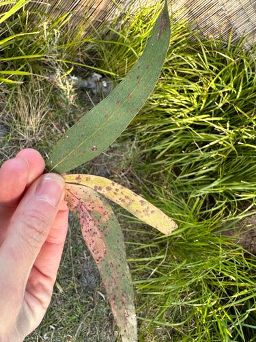

My eucalyptus has a lot of spots and looks poorly what kind of disease might it be and how can I treat it? I believe I am having similar issues with many plants in the garden.

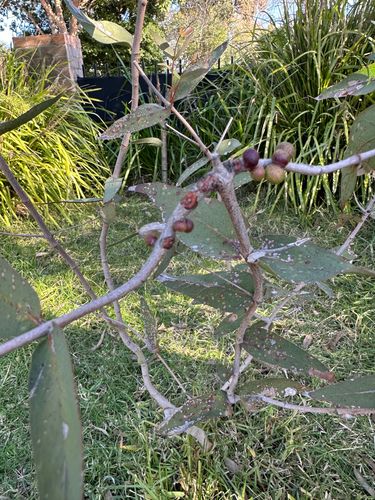

From the photos, it looks like your eucalyptus is showing signs of stress that could be related to fungal disease, insect damage, or environmental stress. The brown, round galls on the stems are a clear indicator of eucalyptus gall wasp. This pest is very common on young eucalyptus trees and causes the tree to produce galls on leaves and stems, leading to distortion, dieback, and overall poor health. The red and brown spotting on the leaves may also be linked to fungal issues such as Mycosphaerella leaf spot, which is common in eucalyptus when conditions are humid.
The galls along the branches are almost certainly from gall wasps. They lay eggs in the soft tissue, and the plant reacts by forming these swollen lumps. This weakens the tree, diverts nutrients, and makes it more vulnerable to secondary infections. The spots and patches on the leaves are likely fungal in nature, especially if you are noticing similar symptoms on other plants in your garden. That suggests your garden may have a high fungal load in the soil or air, often triggered by damp or crowded growing conditions.
Unfortunately, there is no simple chemical cure for eucalyptus gall wasp. The best approach is cultural and biological management. Prune out and destroy (do not compost) affected branches to reduce the gall wasp population. Encouraging beneficial insects such as parasitic wasps can also help naturally reduce numbers. For fungal leaf spot, improve air circulation around the tree by pruning nearby plants, avoid overhead watering, and collect and dispose of fallen leaves. A copper-based fungicide such as Yates 200ml Liquid Copper Fungicide or Yates 150g Mancozeb Plus Garden Fungicide And Miticide can be used on new flushes of growth if the fungal problem becomes severe, but focus on prevention first.

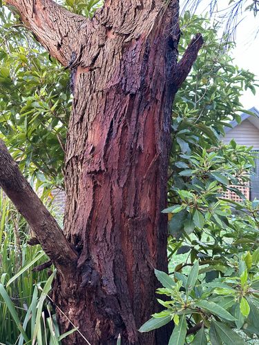

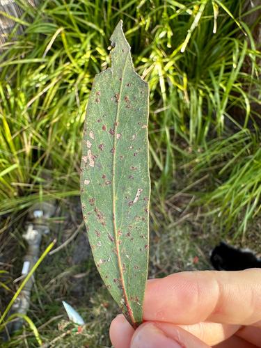

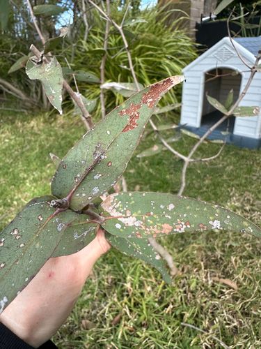

Thank you. The grey irregular shapes spotting is not pest damage? My larger parent gum tree also has this leaf damage and now has substantial kino seepage on the trunk. I’m not sure if I need to make a seperate post for each plant or species but I am worried about Phytophthora although I don’t think that’s associated with spotting? My other larger eucalptus has red spotting on the leaves as well but no sap issues. I have found small caterpillars on the leaves of one. The canopy on both the large gum trees looks good. I previously had issues with overwatering the lawn with duck pond water (it developed grey leaf spot), and allowing the grass and plants to be overgrown. The overwatering was stopped 2-3 years ago, but the plants have just gone downhill steadily or some appear to be stunted growth wise. I had some grevilleas with mold like spots on the leaves and trunk that had severe foliage die back that I just pulled out. Others like lomandaras have just seeded into more plants and appear to be fine. The lomandras had crowded out the base of the larger gum trees which I assume gave a mulch like affect that isn’t good for them. I also have two acacias that appear to be suffering from severe dieback of the leaves but no spots.

The grey, irregular patches and mottling on the eucalyptus leaves look more consistent with chewing or skeletonising insect damage and possible fungal or bacterial spotting rather than being a direct indicator of Phytophthora root rot. The small caterpillars you found are very likely a primary cause of the leaf chewing. Eucalyptus trees often host leaf-eating larvae such as sawfly larvae (spitfires) or various moth caterpillars, which leave patchy holes or irregular areas where the leaf tissue has been scraped off.
The kino (red sap-like resin) seeping from your larger gum’s trunk is a different symptom and usually indicates stress or wounding. Kino exudation can be caused by insect borers, fungal pathogens (such as canker-causing fungi), mechanical injury, or environmental stress. It is not diagnostic of Phytophthora by itself. Phytophthora root rot typically shows up as crown dieback, reduced canopy density, yellowing leaves, and poor new growth due to root decline, not spotting on leaves or kino on the trunk.
