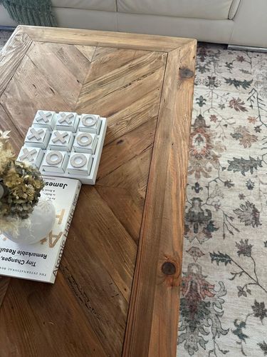

This image with book is the color of wood that i want and the other picture with soundbar is red merbu that i want to change. I did only one coat of walnut oil and stain.

The inspiration image is natural timber with a weathered finish. It wouldn't really be possible to go from a heavily pigmented Mebau and end up with something similar. You could continue with the Walnut stain and have a very dark Walnut coloured panel. The only way to get close to that would be to start with a much lighter-coloured timber, like Pine, and add a walnut stain to it.
