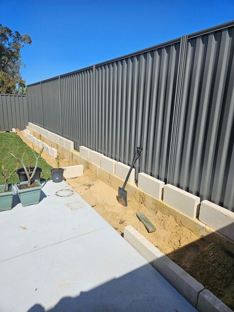

I’m planning to build a 490mm raised garden bed using 2-course 500x245x90 blocks (25kg each).
So far, I’ve compacted the Class A sandy soil and intend to add cracker dust for better stability. The bed will be 12m long and hold roughly 2m³ of soil. I’m setting the first block with 150mm of it into the trench.
Would concrete footings be necessary for this setup, or is there a way to build it securely without them?
