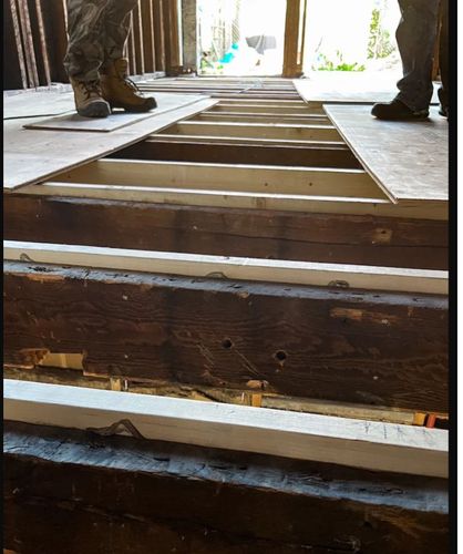

Hey friends! I’ve got a sunroom (5m L x 3m W) which used to be part of my rear balcony and I believe it was closed off previously. As it used to be a balcony the floor joists and floor slope down away from the house about 5cm over 3m I’m looking to lay hybrid flooring throughout the house and thought I should level this room.
The current joists are hardwood 120mmx50mm at 450mm spacing
My approach was to remove the yellow tongue floor and nail/screw new timber to the existing joists to bring it to level and reinstall the yellow tongue back onto the new timber.
If this approach is feasible what size timber would I use to attach to each existing joist and what fasteners to use.
I’ve attached an example I saw online of what I want to do.
