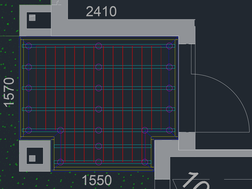

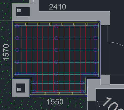

First time building a deck for a first time home owner. I'm currently designing it (thankfully have some cad skills to lean on)
Dimensions as per attached. Yellow = frame (90x45 H3), cyan = joists (90x45 H3), blue = Picture frame (140x19) red = decking timbers (140x19), purple = 90OD smallfoot pedestals.
Have designed for a 10mm gap between the rendered brick (In grey) and the frame as well as the rendered brick peirs. 5mm gap between boards and 19mm gap at outer edges for fascia.
Joists are spaced at about 320mm.
Sil to slab is 172mm, so presumably if I want the deck to be level it would be 172 minus the deck thickness (19mm) and minus the joist (90mm) leaving me with 63mm to fill with the pedestals (provided the slab is flat of course)
Is this is approprioate layout for the pedestals? I'm mostly concerned about the outer frame (in yellow) being unsupported, as I don't want to bolt that into the render. Do I need to use something else to support the outer frame or is it ok to just hang off everything else?
