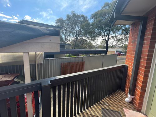

I want to install vertically two Matrix Screen 900x1800 screens on my deck. I understand that the screens need a Matrix C-Channel Frame Kit to make them sturdy and the screen with the frame is meant to be attached to a post using a supplied galvanised steel bracket. With the C channel frame the screens measure 915x1815 each.
The deck is about 1.5m above ground so I can’t/don’t want to follow the matrix instructions to cement a post or attach the Matrix post to a cement base.
The deck railing is 900 high and the top rail has a lip of 47mm on the deck side (it is flush on the outside). It can be windy from the street side across the deck but not the other way.
The portion of the deck that I want to install them on is 2250 wide. I’m happy to have gaps or to fill those gaps with a support post.
Could you give me a few options? The least amount of adjustments is preferred. That is no cementing and the minimum amount of drilling and extra purchases is preferred.
