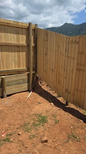

Hi there. I'm trying to figure out what to put as an edging for the right hand side of our fence. For starters our lot is about a meter high from them. When the contractor built the fence the neighbor didn't go for a retaining wall so the fence was just erected as per the natural contour of the land. We want to make a paver pathway so I need a way to support those pavers along thw fence.
My initial thought was to use 200x50 h4 sleepers against the pailings and just drill them to the posts and support it with like jack 450mm sleeper pegs. My worry with this is the whole fence might topple over either side because of the sleeper's weight. Another thought would be just to haunch it with cement. Another is tuscan path stone edging. Ideas would be amazing at this stage. Thank you.
