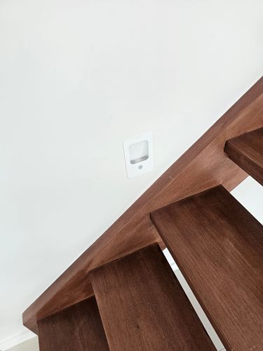

how to make this darker. its caoba, freshly done, I would like to make it to dark chocolate

Its Durian timber stain grade color: Caoba.
Primer was 1 coat Johnston's Tuntable primer, and 2 coat johnson's interior/exterior semi gloss
I have just been in contact with the Johnstone's technical team. They have advised that the only way for you to achieve the colour you are after is to sand the stairs back to timber and get a new tintable primer. Placing another coat on top is not an option as the result will be unpredictable. In order for you get a better idea of the finish, they have suggested that you proceed to a Taubmans trade center close to your area. They will have the Johnstone's colour samples applied to timber which you can actually see.
