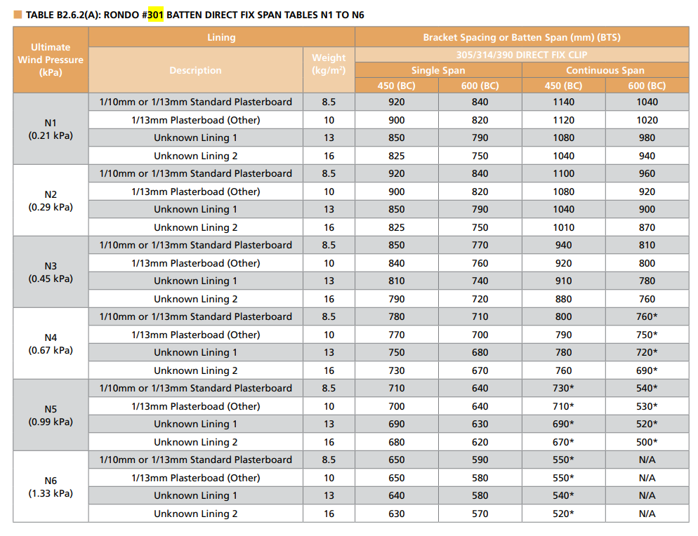

I would like to install rondo furring channels to even out the ceiling but I'm unsure if I should use rondo 301 or 308 (16mm). The 308 seem to be the slightly better choice but the manual states that 301 should be used for residential ceilings.

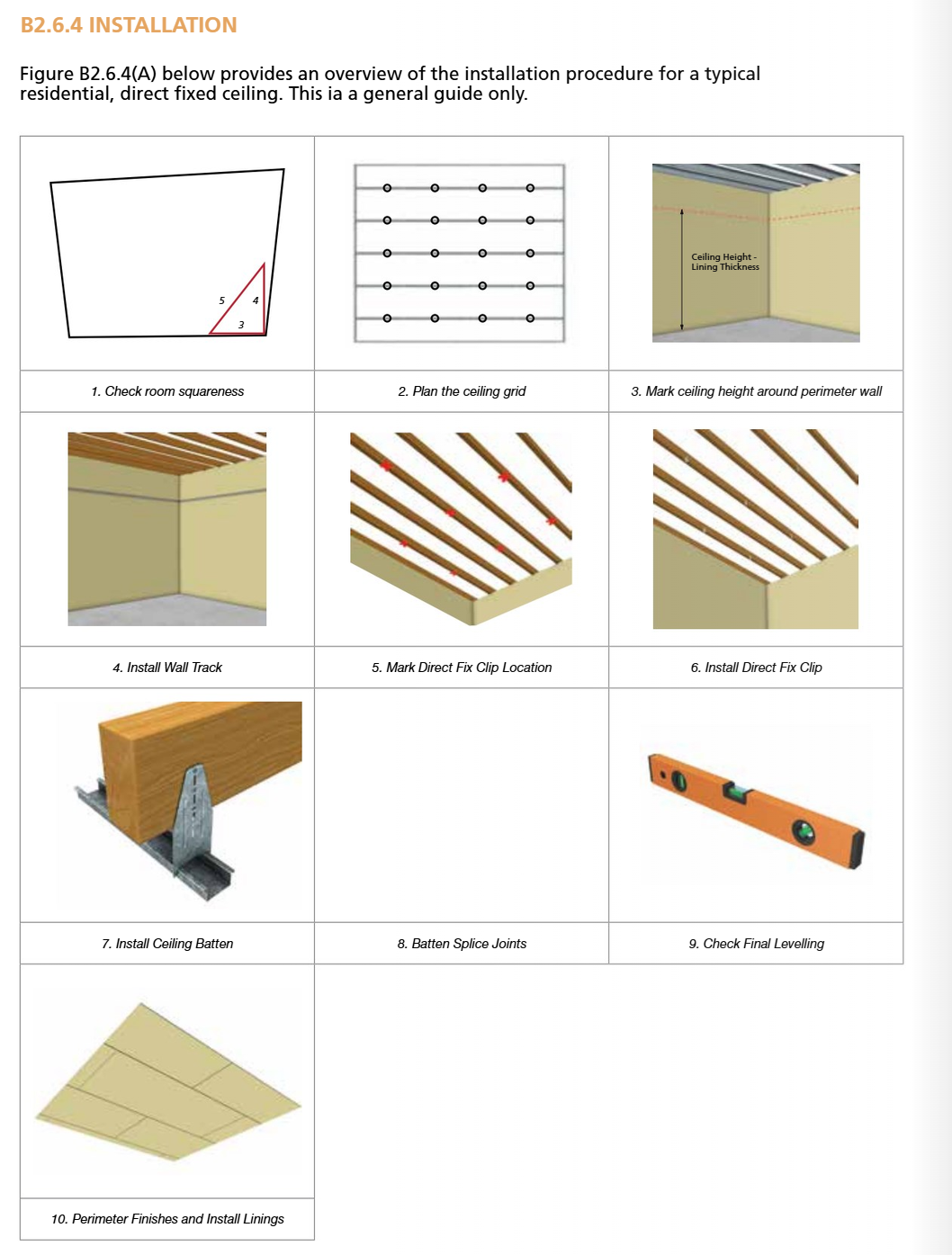

My ceiling joist are 600mm apart and I planned to place the new furring channels 450mm apart and secure them at each joist.

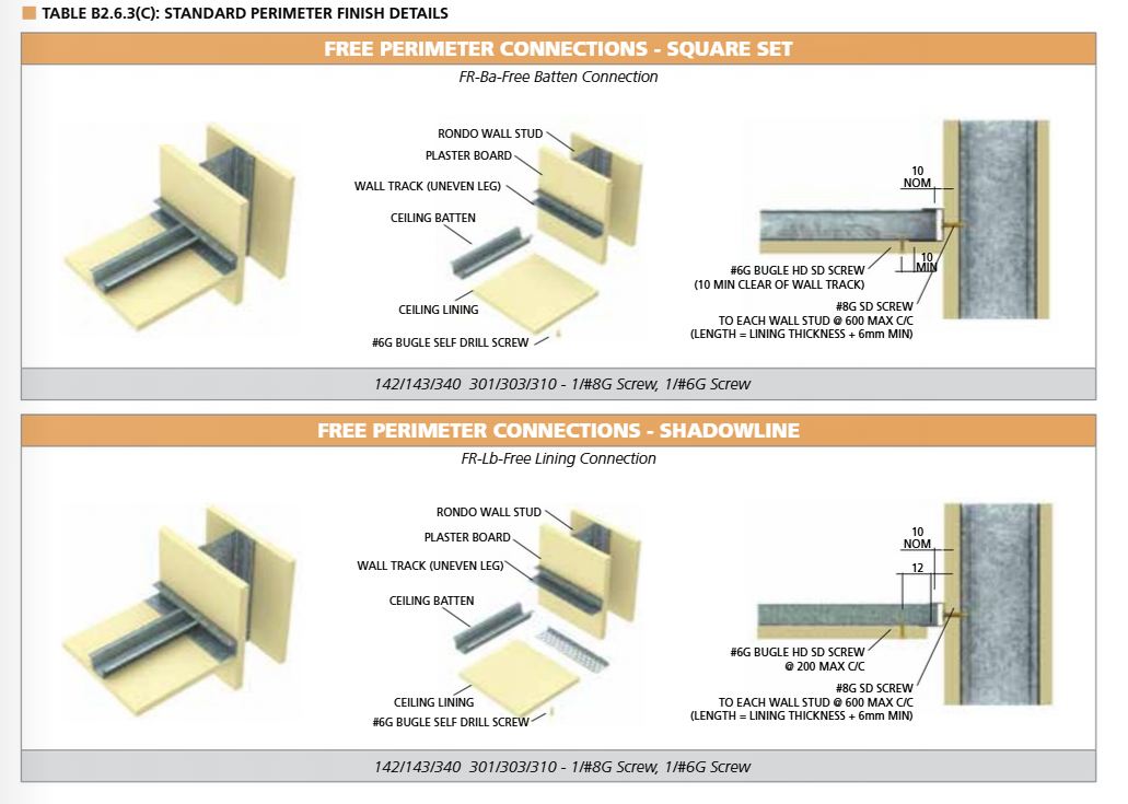

But how far from the wall should the first and last furring channel be placed to support the corners?
Should the 142 wall track be used as well?
The wall hight to the ceiling is around 2420mm and the new wall plasterboard would just leave around a 10mm gap to the bottom and top.
Should I install the the new wall plasterboard first to ensure its screwed into the top plate and then install the ceiling channels and plasterboard?
The old plasterboard on the ceiling was 13mm thick but I would like to either use 10mm SHEETROCK ONE or 10mm supaceil for the ceiling plaster would either of those 10mm plasterboards be suitable or should I go with 13mm?
