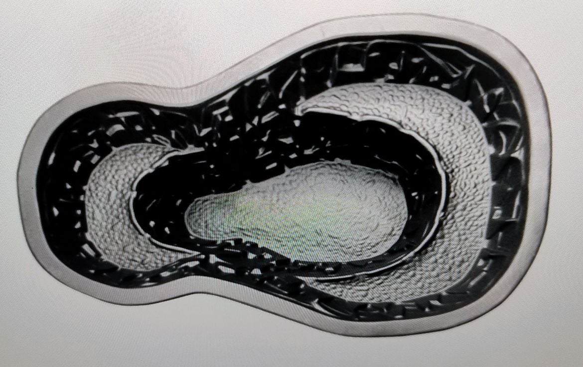

Step 1
Measure the area and decide on the ideal preform pond.

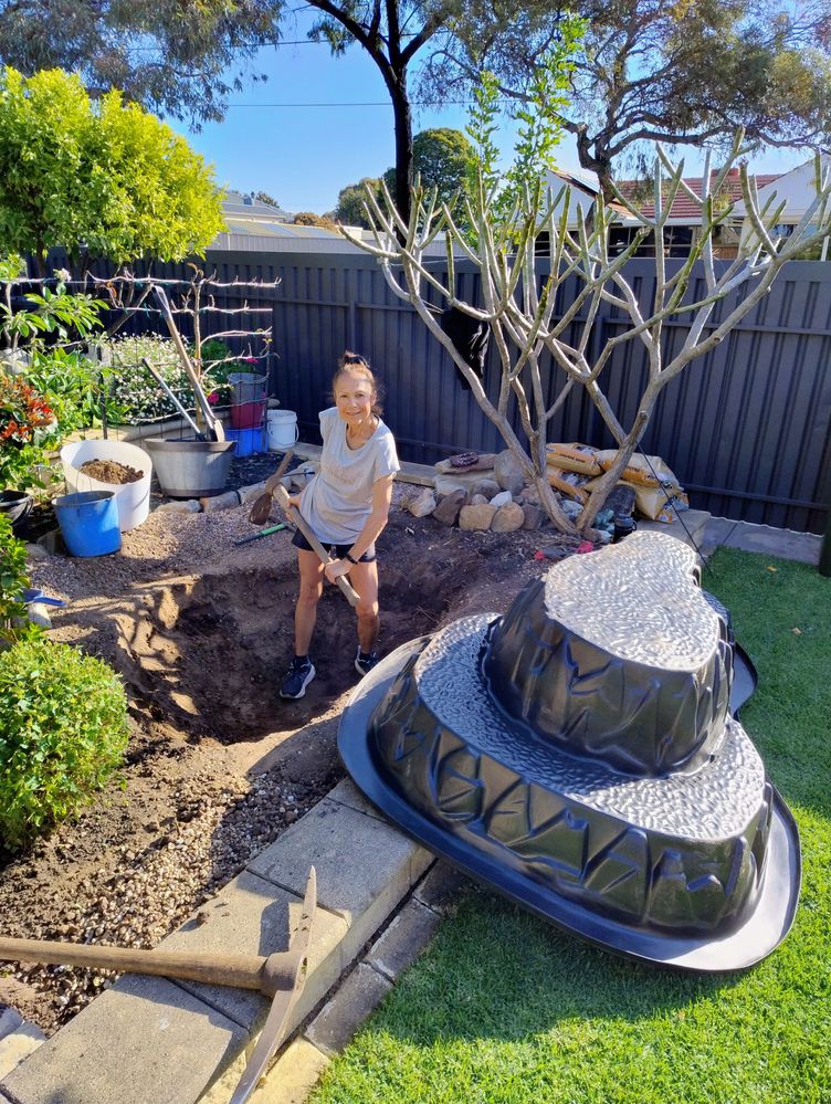

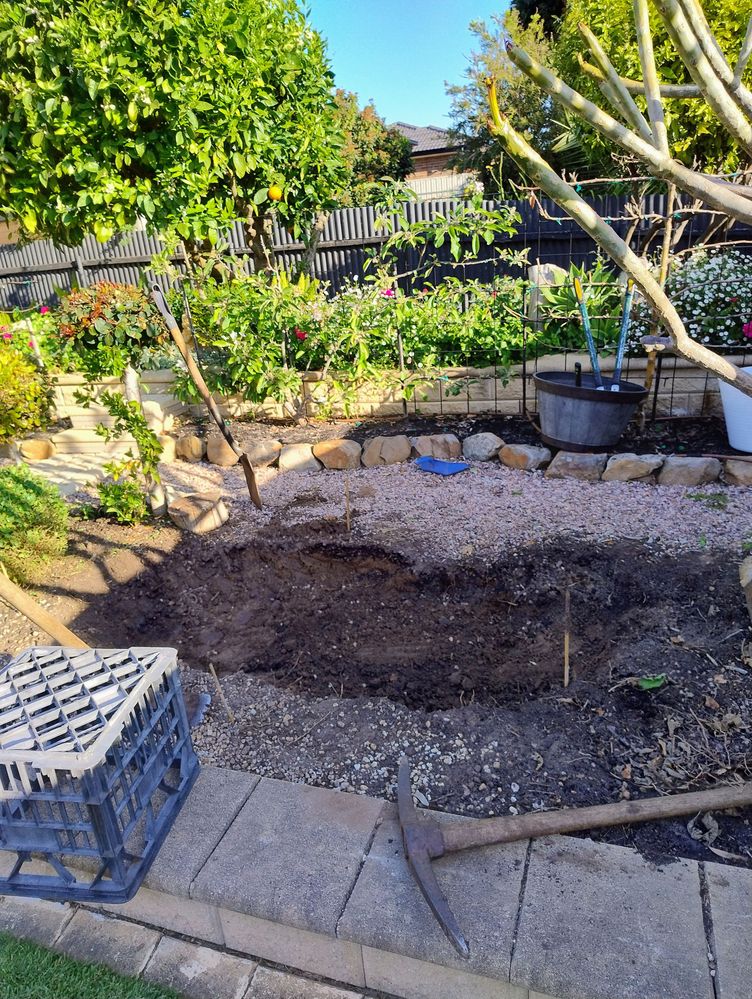

Step 2
Start digging. Keep digging! And smile even though you have no idea what you're doing!

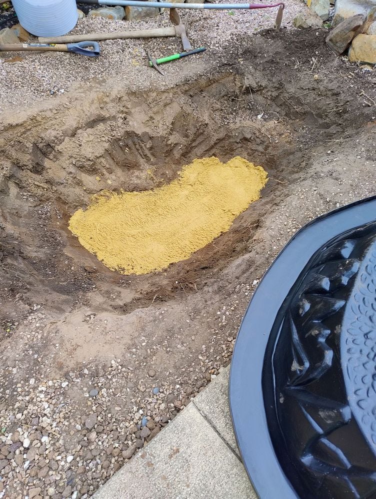

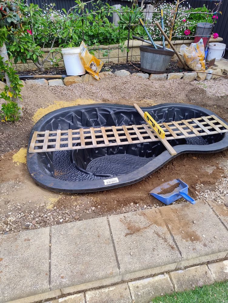

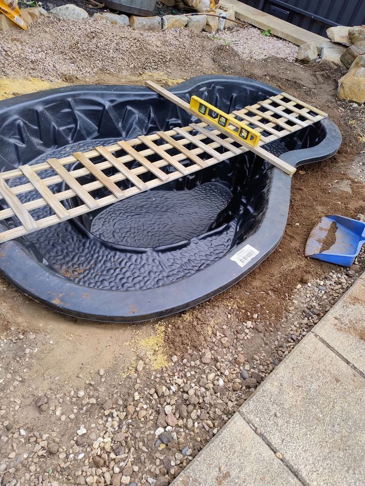

Step 3
Line base of hole with landscaping sand ensuring it's level. Use a spirit level to ensure the preformed pond is 100% level vertically and horizontally. Then pack in the sides with more landscaping sand and ensure there are no air holes - pack it in tightly!

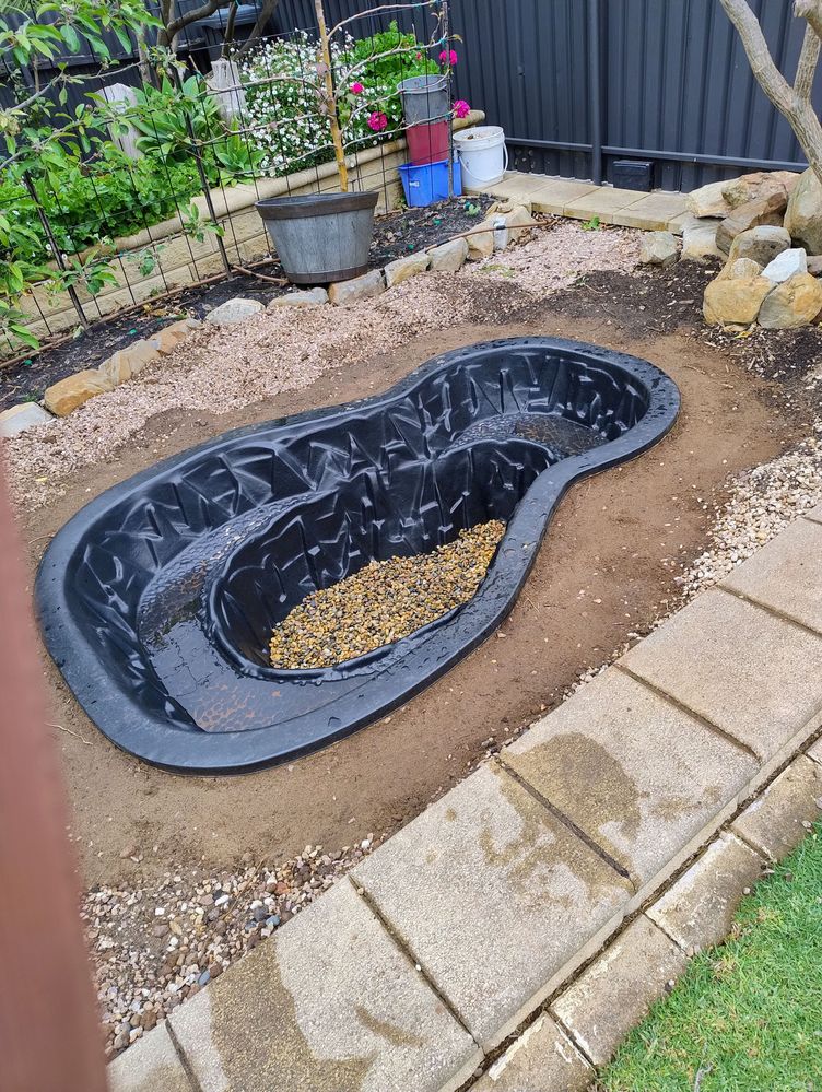

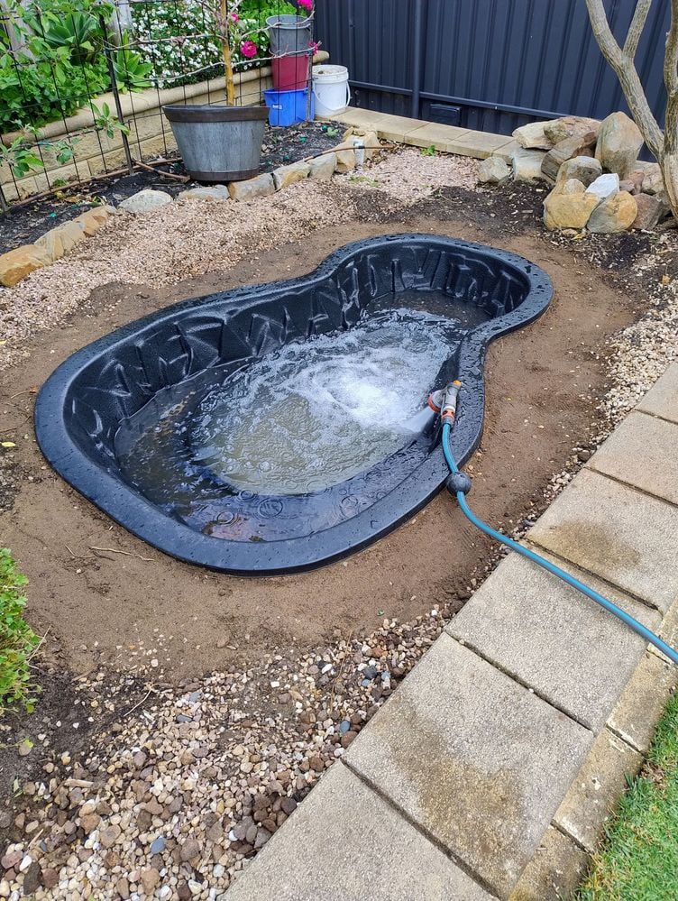

Step 4
Line the base of pond with river pebble stones and start filling with water.

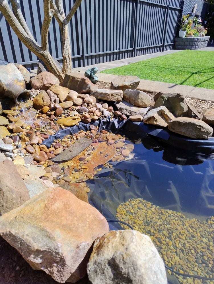

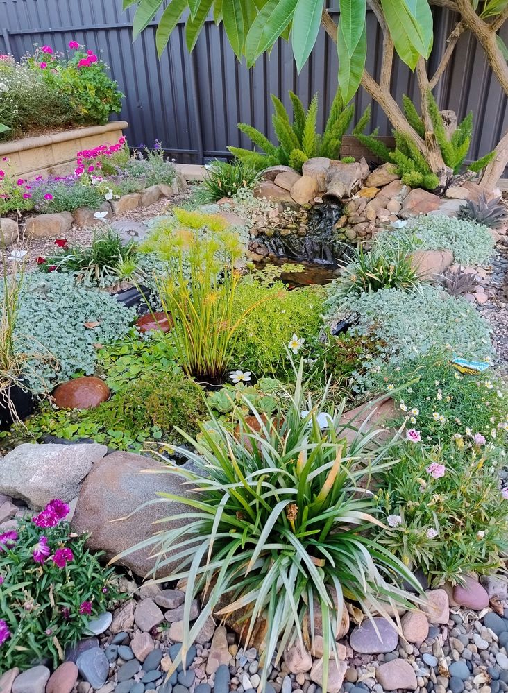

Step 5
Time to have fun with rocks and setting up the filter and water pump. I created a cascade effect with tubing running from the filter and into an old urn I found in a neighbour's hard refuse. I used AquaPro pre-packed pond liner under the pebbles and rock and draped it into the preformed pond liner. Also add AquaPro pond treatment and conditioner to the water!

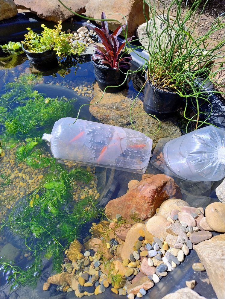

Step 6
Now the exciting moment arrives... Time to introduce the fish and start adding plants.

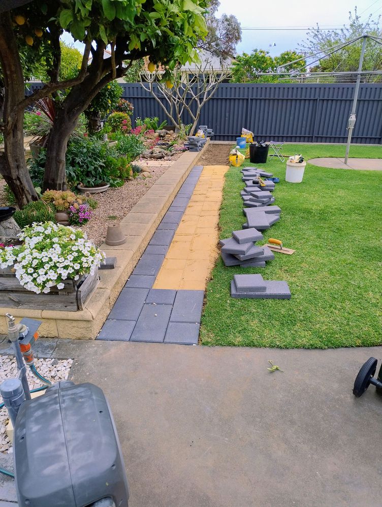

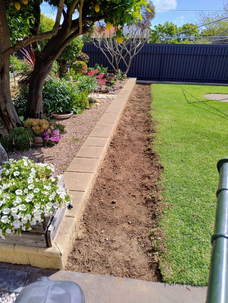

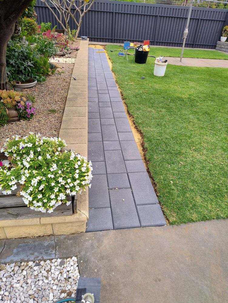

Step 7
Having finished the pond I thought about how good it would be to add a path so I would avoid walking over the lawn to access the pond. So, more digging!
Here I used charcoal Brighton Masonry pavers 400 x 200 x 40mm and Brighton Masonry pavers 200 x 200 x 40mm and more landscaping sand.
Step 8
Finished off the pavers using Dingo Power lock polymer paving sand.
