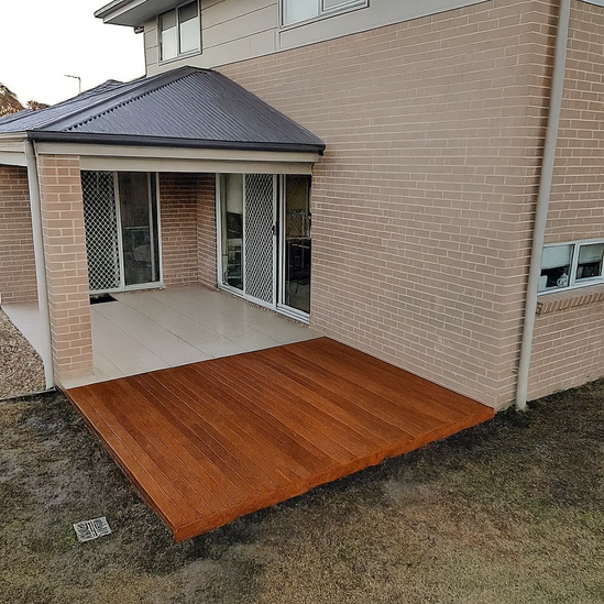

Basically, I want to extend my tiled alfresco with a deck of size 3220 mm X 3160 mm very similar as shown in the photo below. Since I want to make the deck level with the existing alfresco, I have only 140~150 mm height to work with.

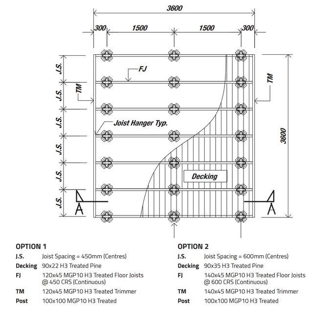

Option 1 - TuffBlock: If I use TuffBlock, then I will need a some digging as I need to use 400X400X40 paver + TuffBlock + Joist + deck board, giving me a total height 40+50+90+23 = 203 mm. But currently I have 140~150 mm. I can use roughly the following framing as shown in the ToughBlock installation document. I will need 7 joists and 21 TuffBlocks as shown below. But I will need to work precisely with the height to level the deck with my alfresco floor which I am not very confident about. Any suggestions so that I can be precise in maintaining the deck height level with my alfresco floor?
Option 2 - Small foot: If I use small foot, then the total height will be 40 (paver) + 35 (small foot) + 90 (joist) + 23 (deck board) = 188 mm. I will need a bit digging, but its flexibility is adjustable height. According to Small foot specification documents the 90X45 joist can be up to 500 m apart, so I can use 7 joists as above. But the small foots supporting each joist need to be 400 mm apart, which means I will need 8 foots per joist. So in total I will need 7 X 8 small foots. Is this calculation correct? Or I am making some mistakes as 56 (7x8) small foots seems too many. Do I need to use the 400X400X40 paver under each small foot?
