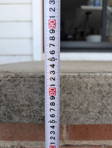

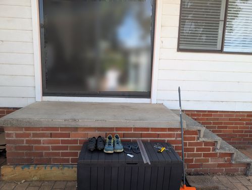

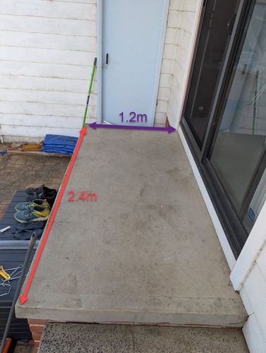

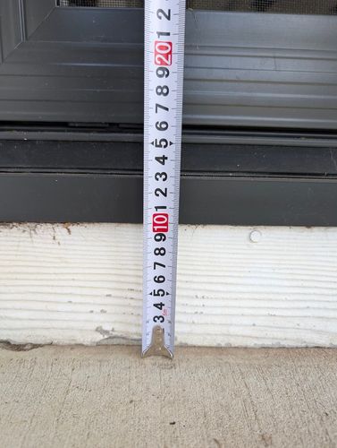

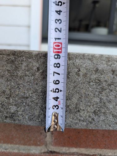

Amateur DIY-er here, I'm currently planning out the build of a deck over a concrete landing at the rear entrance of my house. First off, a few photos to show the current setup, as well as some of the dimensions. The main slab is 2.4m by 1.2m, with a thickness of approx 10cm. The top of the slab is 83cm from the (stamped) concrete patio below. For the house side, the slab to the bottom of the sliding door is 13cm, and the slab to the metal trim angle is 10cm.I also want to deck the stairs in the same format, but planning around the main landing area first.

1. Should the deck go to the bottom of the metal trim/angle, or the bottom of the sliding door? I was going to go to the bottom of the sliding door, to reduce the height difference between the inside room floor and the finished deck. If to the bottom of the sliding door (13cm), I could use 90x45mm for the joists, then with 19mm decking boards have approx. 21mm+ spacing between the joists and the concrete.

3. The finished deck height (assuming using bottom of sliding door) to the concrete patio below would then be 96cm - I'd like to also put in a balustrade/guard rails around the landing and down the stairs. I saw the Peak Aluminium balustrade kit, however noted that the fixings for the post brackets had to be 70mm away from the edges of the concrete slab (if going directly to the concrete) - this would reduce the already narrow space. I was thinking I could fix some posts (merbau, if matching with the decking) to the concrete patio below, and then join them to the deck frame using bolts. The balustrade could then be built using these posts as supports, including a handrail down the stairs. For a 1m handrail, the posts would then be about 2m+ tall. Would bolting (chemset, dynabolt) the posts to the patio below be okay with the additional fixings to the deck frame to reduce the lateral strain? Or would I need to core-drill and cement the posts in?
