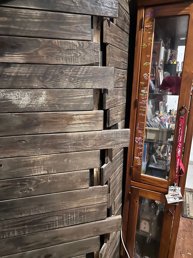

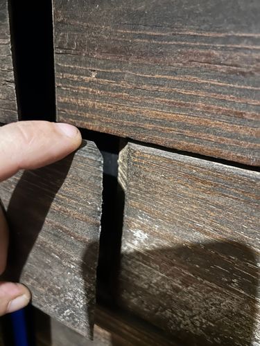

45 degree cuts on the opening side of the door.

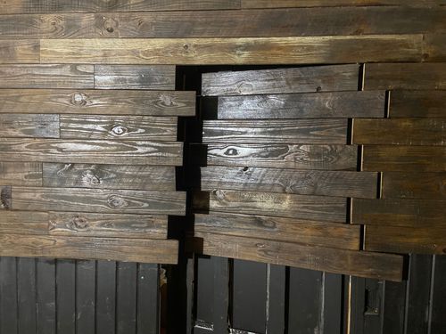

Lining each layer up as you go.
I started at the top to ensure and gap at the bottom could be covered with the skirting.
Butt joints are used across the wall.
Each piece of the recycled timber is brad nailed to the wall.
With a simple opposite 45 Degree angle cut on the side of the door that is opening inward as seen in the picture.
Ensuring there is enough gap not to foul.
I also used a level to match the door sections to the wall to ensure continuity.

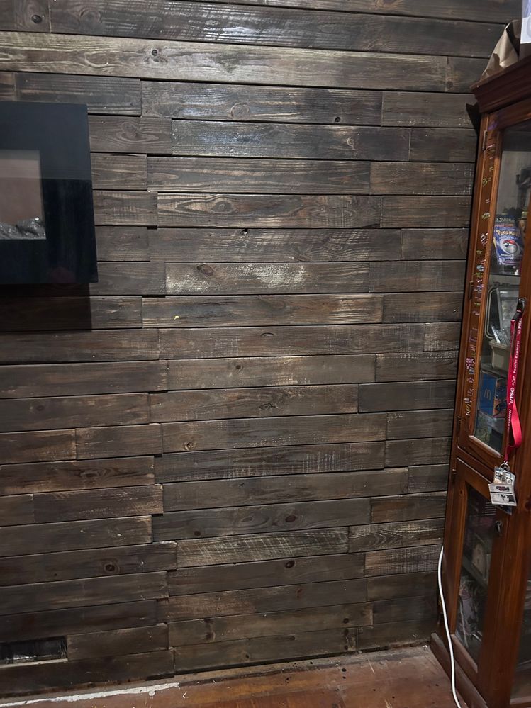

Step 3

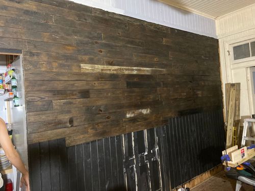

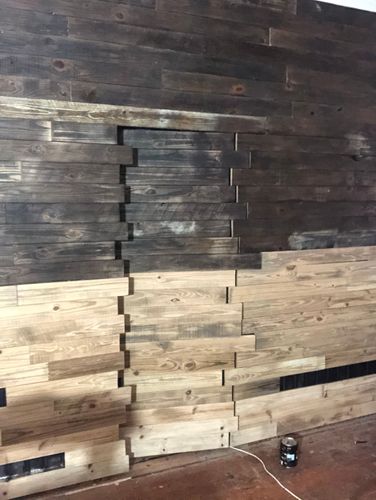

Continue adding the panels until the door is covered.

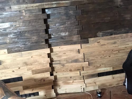

As you can see i couldn't wait for the stain to dry after i had ran out of the ones i prepared the day before. So i added them to the wall and had to paint them in situ. I would highly recommend being more patient then myself.
Step 4

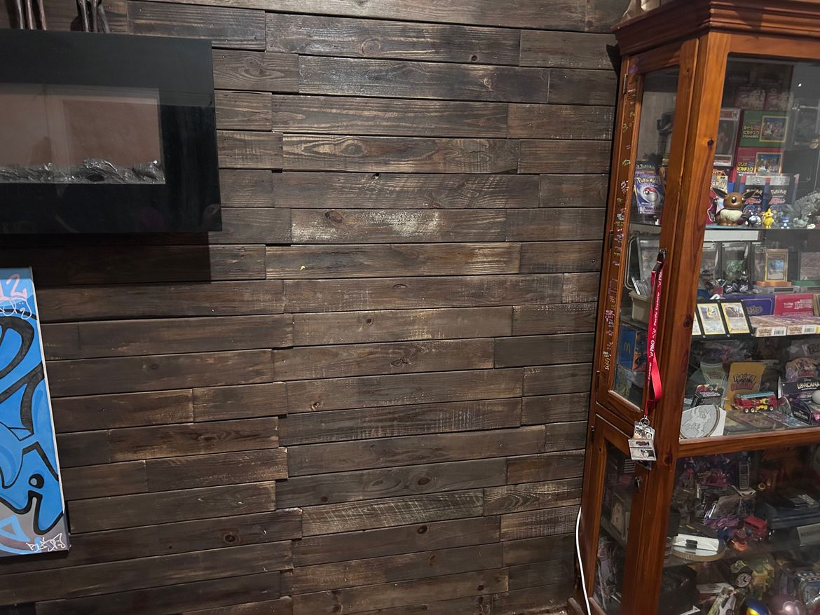

And complete.
