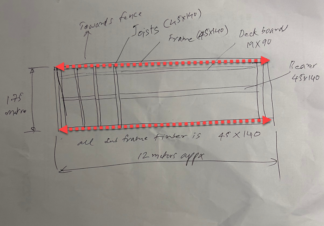

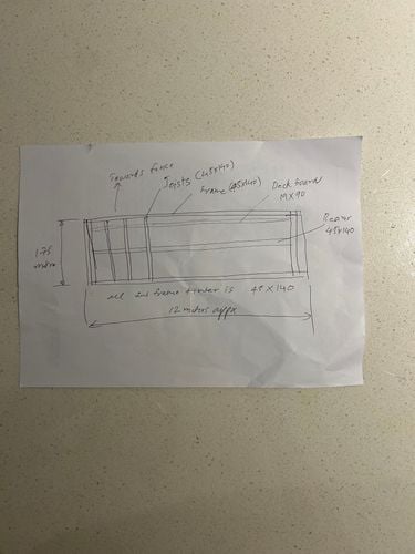

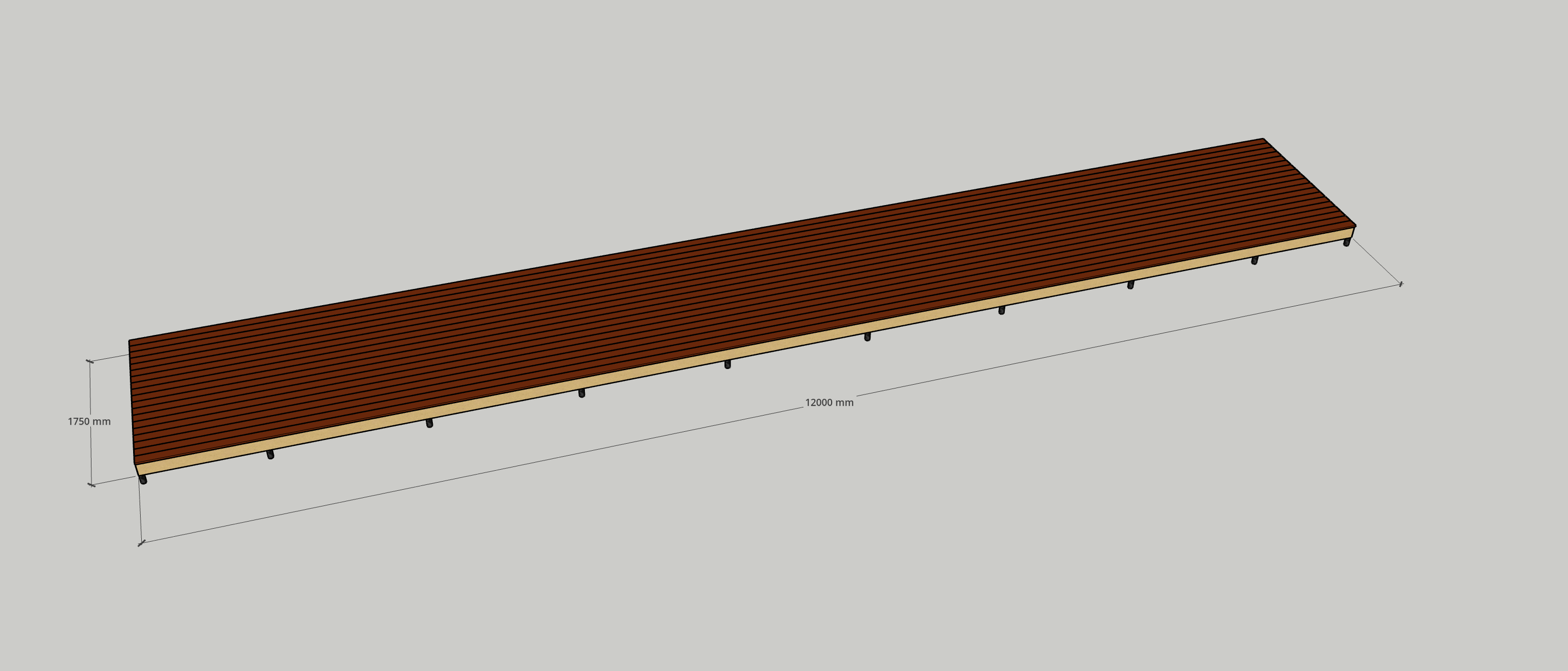

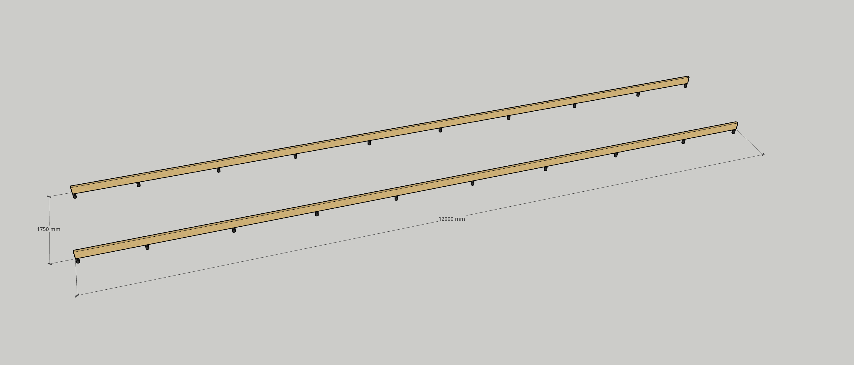

Hi, I’ve built a few decks mainly on concrete using Klevaklip adjustable joist supports where the height has been very limited. Now I want to extend that deck out into the backyard. The extension will be 1.75 meters by 12 meters long and again due to height restrictions I can not use bearers except for one running in the centre. The timber I’ll be using is 45x140 treated pine for everything with the joists spaced at 450mm and the deck boards are 19x90 merbau. I would like to know what your recommendation is in regards to the number of supports I would need. Attached is a rough drawing, thanks. This will be a free standing deck
