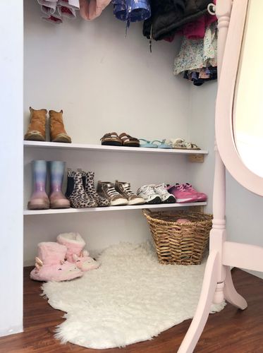

Here’s a quick & simple little project I did a few weeks back in my daughters room - a cheap shoe storage solution!

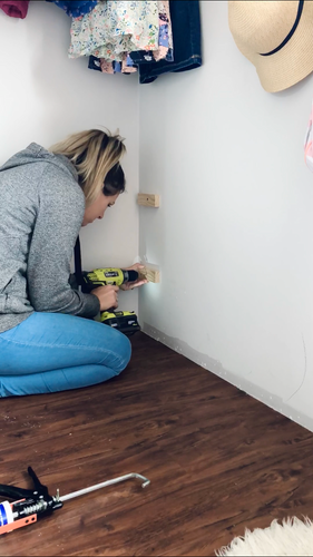

I used some timber off cuts I had laying around, cut them to size (approx 50mm smaller then the depth of the shelves, glued them to the wall with some Hold Up and also put one screw in the middle for extra support, then glued the shelves on top. The shelves I used were the Flexi storage 16mm white timber shelves, I think they cost me around $11 each, the lengths I got were 900mm which actually fit perfectly in the wardrobe so I didn’t need to cut them down which was a bonus. 👍🏻
I can’t find my “before” pic but just picture shoes spread out all over the floor. 😅 This is defiantly an improvement!
