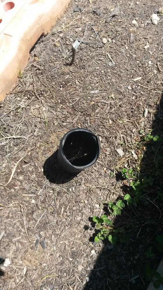

We generally place tubes like these next to trees when planting as they allow you to water deep down into the plant's root ball. They prevent excess evaporation of surface water and make sure all of it is directed to where it's needed. Simply place your hose in the tube for 10mins for deep watering of the plant. You'll often find councils use this agricultural pipe method on trees they plant on the nature strip. Whilst establishing the plant, a council water truck with a boom arm will come along and water them through the pipe.
@MitchellMc
thank you for the information. i never know about this!

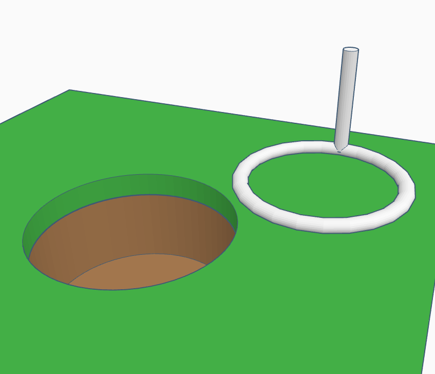

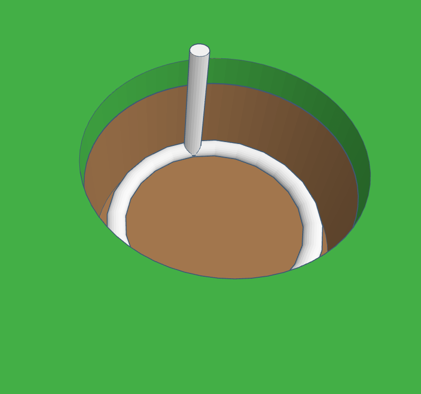

The Agi-pipe will be inserted into the hole before planting the tree. You'll need some Vinidex 65mm x 20m Draincoil With Filter Sock and a Vinidex 65mm Draincoil Tee. Create a ring of Ag-pipe slightly small than the circumference of the hole. Attach the ends of the pipe to the tee piece. Cut another section that's slightly longer than the depth of the hole. Connect this to the third outlet on the tee. Lower your watering device into the bottom of the hole.
You can then backfill with some soil over the Ag-pipe and plant on top. You want the Ag-pipe to sit slightly lower in the hole than the tree roots ball. That way, the roots can see the water instead of sitting directly in it. I've created a quick rendering below to illustrate.
