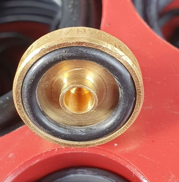

I'll take a punt and say @chengjianer had no success whatsoever - IF - it is the same designed 'O' ring and brass construction as illustrated below.
It's not even an O-ring as such.

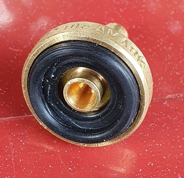

These are from Bunnings - I can research the brand - but they're useless in my situation. I have an autistic son who habitually over-tightens taps. At first I found it hard to believe - but he can apply enough tap torque that forces the brass rod into the tap fitting and as a result the washer (or call it an O-ring) compresses, such that the small inner brass washer is 'punched' off and displaced. 😁
To try and replace it? Simply not worth it - in my opinion.
Cheers!
Graeme.

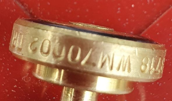

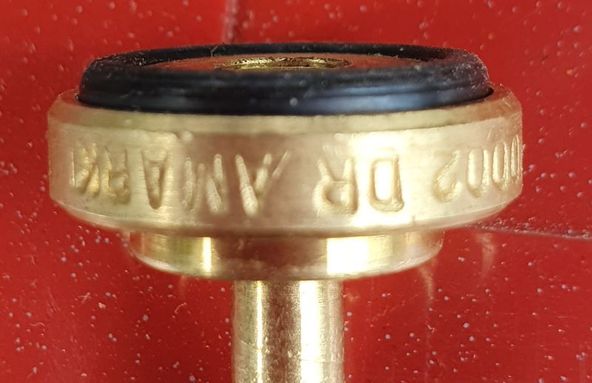

I estimate with crude vernier calipers that the 'original' rubber washer (my product above) is 3.6mm thick, and that's why it sits proud from the brass back and that's what creates rubber pressure to stem the water flow...
Original
Sitting proud
I selected R10 2.38mm. Even If I lubed and managed to squeeze the O-ring into place with an intact brass fastener (which I couldn't do) the thickness is still not enough to occlude high pressure in the tap...
Looks OK, but....
Just no proud enough...

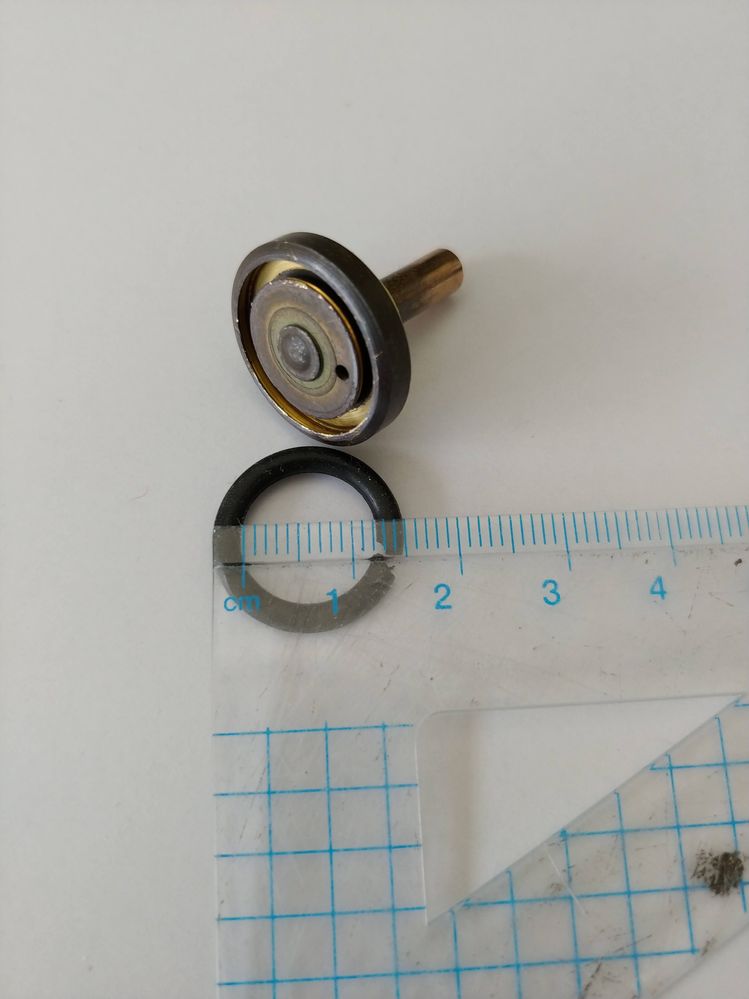

As shown in chengjianer's original post, it is an actual o-ring serving as washer in the valve assembly. Mine is the exactly the same. The brand is HydroSeal.
Yours has some similarity but differs significantly both in how the rubber fits into the metal base and the depth it fits into it. The o-ring fits very tightly into HydroSeal valve's circular groove so much so it is very hard to lift it out without breaking it. Which also means it is very hard to squeeze a replacement o-ring into the groove. With yours, the rubber washer is sandwiched in position. So it requires a specialised rubber washer with thinner middle and thicker edge. I can't imagine an o-ring will do the job.
If we can figure out an easy way to replace the o-ring of Hydroseal valve, it would almost be the end of buying new tap valves as the metal part lasts forever.

My sincere apologies! I have misinterpreted @chengjianer's photo above thinking the original rubber was shaped like mine but he was trying to insert the traditional O-ring style as a replacement.
"HydroSeal"
I have heard of them and I think I tried them in the past. I now see the small hole and a much better riveting system than mine.
I was thinking we could lube up the appropriately sized O-ring with paraffin and position it between soft aluminium - and squeeze into place with a vice. Have you tried that?
I'll buy a couple of hydroseals over the weekend - and give it a go.
