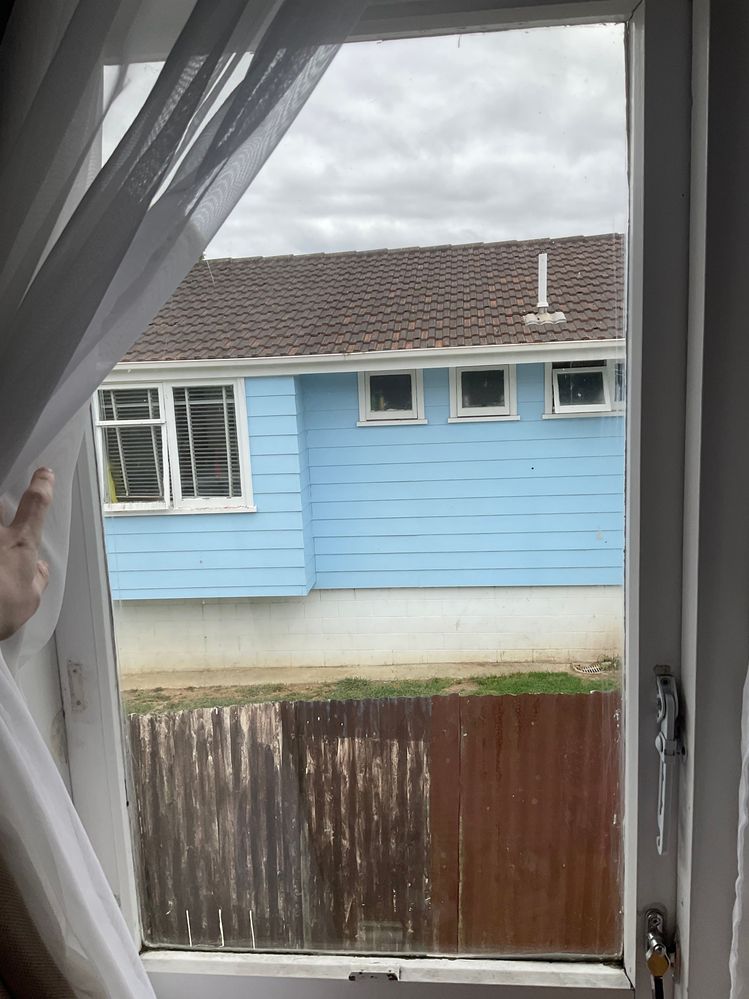

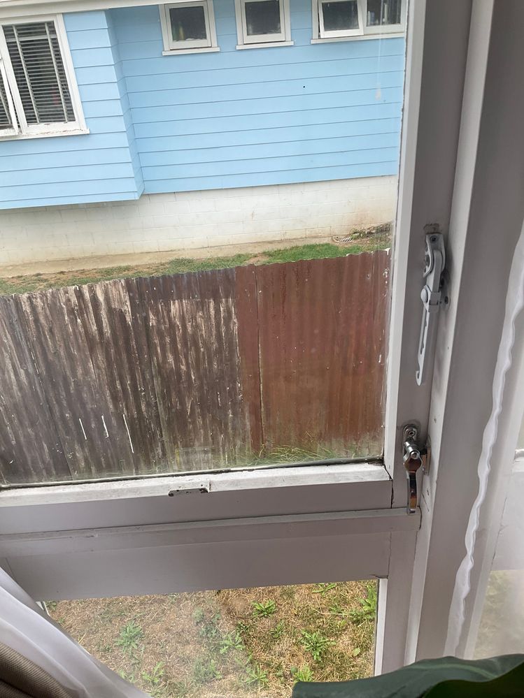

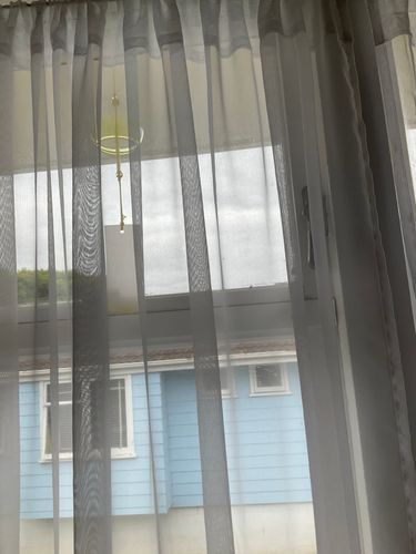

Hi there. I tried taking these pictures.
I’m not sure where gap is exactly but I know air is coming in as the curtains move during a breeze with windows closed. I did buy some bubble wrap which I plan on adhering with water soon.
With the window closed and locked, go around the perimeter of the window where it meets the frame and try to slide a piece of paper between the window and the frame. If you can easily slide the paper between the two, then there is a gap that wind could be getting through. If this is the case, I'd recommend the products I linked to above to seal the gap. You can place the sealing strip on the windowpanes exterior timber surround or the house side of the window frame. The idea is that the foam strip is compressed when the window is shut.
Apart from sealing the actual window when it's shut, you'll need to inspect the whole window frame looking for gaps visually. If the piece of paper slides into them, you need to seal them. Use gap filler for finer gaps where the foam strip won't work.
