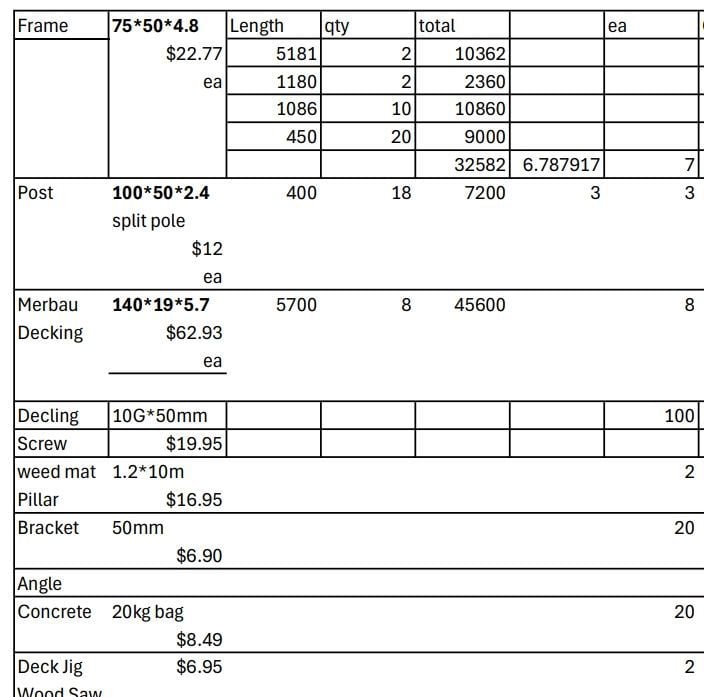

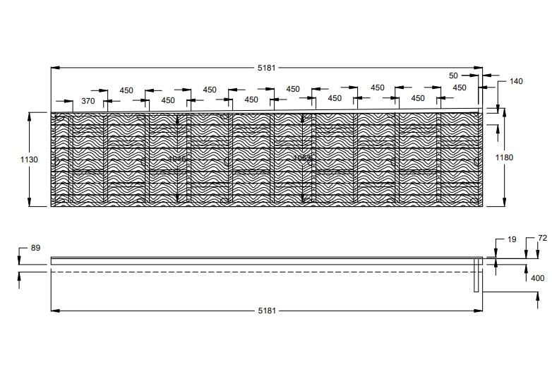

I am planning to build decking outside of existing alfresco floor to be sit on sand. please refer attached frame layout and BOM. I removed grass patch and will put weed mat over it.
Could anyone suggest for building decking post (Qty, type, length etc ) required to build decking frame as attached, Decking area is 5.1mx1.2 m. It is not exactly rectangle. I have considered 100x50 Split Pole type post currently available at Bunnings in 2.4m length.
Is there any easy alternate to installing posts?
Additionally, The Existing Alfressco Floor is only 180mm from Soil that means I will have low clearance under frame. would that be alright.
