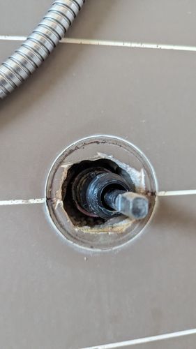

Hi everyone, getting kind of desperate for help. My hot water suddenly stopped working yesterday without warning, I've tried finding online resources for help regarding this but they're all thermostatic showers whereas my shower is manual.
My current line of thinking is that this is a problem with the shower cartridge (although I'm not sure if that exists in manual showers like this one). I want to remove the hot water "screw" but I'm having trouble with it.
Two questions:
1. How do I remove the black plastic attachment off the shower faucet? It's stopping me from disassembling it. There's also a nut which the plastic attaches to but it's too deep to go in with a monkey wrench or pliers.
2. Is there a cartridge I can remove with this type of shower, and if there is, will it fix the hot water problem?
- Identify Screws or Clips: Look for any visible screws or clips holding the plastic attachment in place. These could be hidden under decorative caps, which can often be pried off with a flathead screwdriver.
- Use a Deep Socket Wrench: Since the nut is too deep for a monkey wrench or pliers, you might need a deep socket wrench that can reach it. This type of wrench is designed to access nuts in tight spaces.
- Loosening the Nut: Once you have the appropriate tool, carefully loosen the nut. Be gentle to avoid damaging the threads.
- Pry Off the Attachment: Once the nut is loose, gently pry off the black plastic attachment. If it's stubborn, you can use a small flathead screwdriver to help pry it off, being careful not to damage the surrounding parts.
- Spindle System: Since your shower uses an old spindle system, there is no cartridge. Instead, the issue might be with the spindle itself or the valve seats.
- Inspect the Spindle: After removing the handle and the black plastic attachment, check the spindle for wear, corrosion, or damage. Sometimes, the washer at the end of the spindle is worn out, which can prevent proper control of hot water.
- Valve Seat Inspection: Inspect the valve seat inside the valve body. If it's damaged or corroded, it can block hot water flow. You might need a valve seat wrench to remove and replace it, or a valve seat grinder tool to smooth out any imperfections.
If these steps don’t solve the problem, it might be best to consult a professional plumber for a more detailed diagnosis.

Hello @xdannygeee
Welcome to the Bunnings Workshop community. It's sensational to have you join us and thanks of sharing your questions about your shower spindle.
It's fantastic that you've received excellent suggestions from @PlumbMaster-Zee. Just to add to the recommendations made, I suggest using Magnet Multi Fit Tap Spanner Set. It's been specifically designed to remove spindles and extensions in your wall. I also suggest having a look at this discussion - How to replace old spindle tap? by @tony89.
The black plastic that is attached to the front of your spindle is called a Kinetic 15mm PVC Spindle Bonnet Extender. It's often used when the spindle is too deep in the wall and there are no more threads to screw the cover flange on. Once you have the plastic removed you can use the same tool on the spindle.
Please note that they are slot type socket systems so you can use the long body of the set to clamp on the socket you are using. Please remember to turn your mains water system off and to depressurize your plumbing before you try to remove the spindle.
Here is a handy step-by-step guide: How to replace a tap washer (some of the steps used are applicable to your repair work)
However, if the spindle proves to be too difficult to remove, I suggest engaging the services of a registered plumber.
