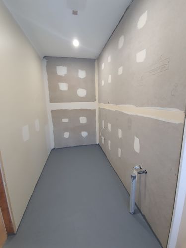

The DIY stuff we will be doing include;
*Removing and installing floor and wall tiles
*Painting lexicon half walls and ceiling white paint
*Installed downlights and patched old lighting hole
*Sheeting the brick walls with villaboard

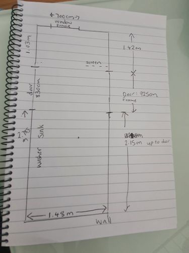

I'm just working on a layout for your area. Could you please let me know the overall length of the room, including the shower? I can see the shower is currently 1.2m and then you have another measurement of 2.7, is the room 3.9m long? Or, is that 2.7m length to the edge of the door?

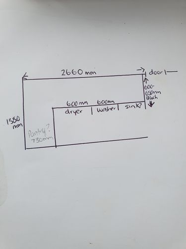

Hi @MitchellMc thank you for your quick response.
I drew this to my best ability of the room including doors, which are different sizes to the door frame. Correction with the wall width is 1.48m. I hope this helps.
Thank you again!

Many thanks for those additional details, @julzdiy.
To clarify, working off the left-hand side measurements, we have 2755mm, 830mm and 1030mm? So, the total length from wall-to-wall is 4615mm?

@MitchellMc sorry it's 2790mm, 830mm and 1030mm 😅
Right side should 2310mm, 920mm and 1420mm
Total wall is 4650mm

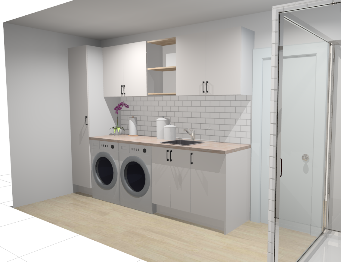

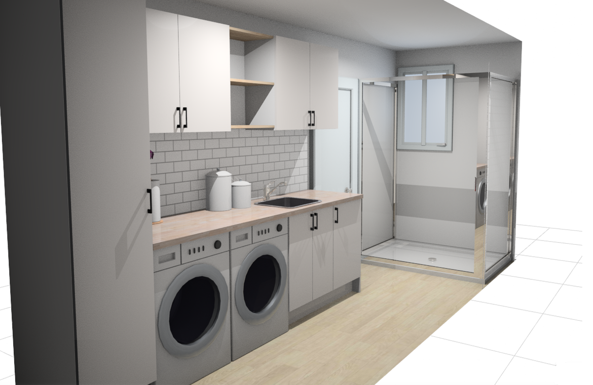

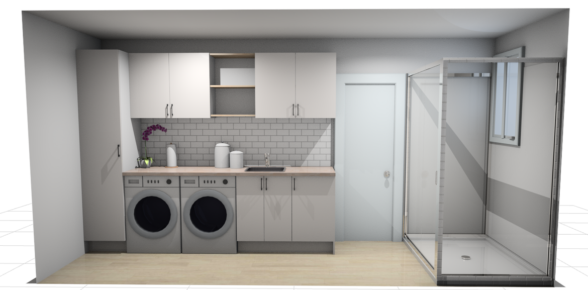

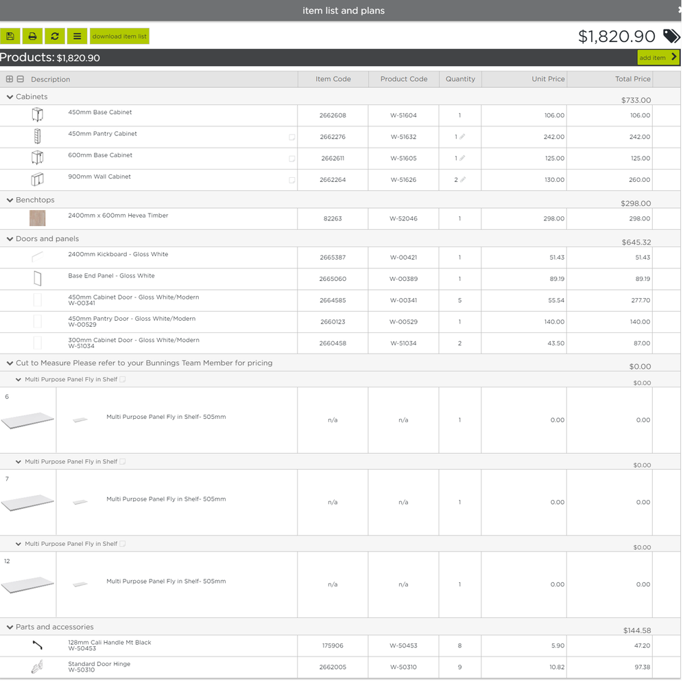

I've put this together for you using Kaboodle cabinetry. Hopefully, it encompasses most of what you were looking for.
Please let me know if there were any adjustments you'd like made.

@MitchellMc thank you so much!! Absolutely love the design!
Will have a proper look in store on the products and will let you know if I have any more questions.
Thanks again for your quick turnaround!!
