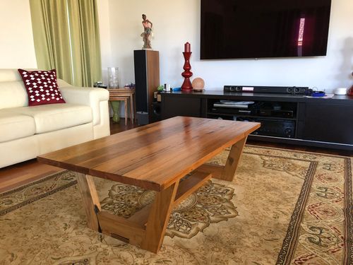

My most recent project was a Coffee Table .
