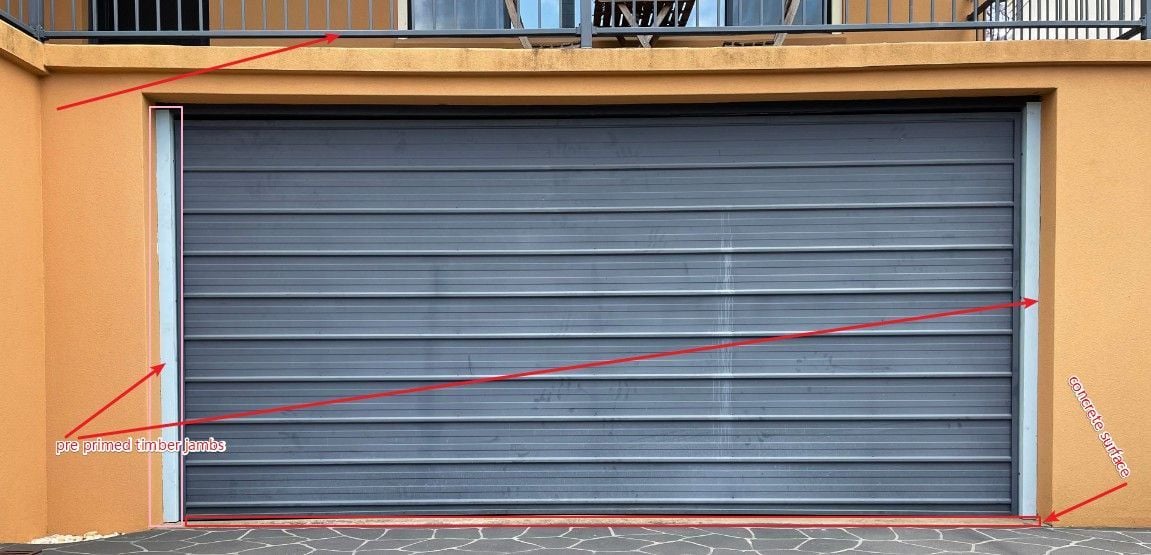

Need to paint the new tilt garage door (steel) and the new timber jambs, probably the porch fence (metal) as well. The garage door is west facing so it receive a lot of UV, especially in summer, so weather and UV resistance may be a major consideration (it doesn't show any sign of rust).

@MitchellMc @EricL Folks, preparing for multiple jobs (stocking tools and paint, etc. over the Black Friday / Cyber Monday period) so didn't do much (also bad weather didn't allow), forgot to ask what type of paint I should apply to the timber jambs, they are pre-primed so I don't need to sand it (I was told).
Don't think the Rust Guard is appropriate for timber, as the jambs' two sides are facing the setting sun as well as exposed to wind/rain, I reckon it requires some sort of UV/weather resistant paint / or even multiple coats.

Hi @terrywang,
Dulux Weathershield would be my first recommendation for exterior pre-primed timber. It has UV protection, is resistant to all weather conditions and is guaranteed not to peel, flake or blister for as long as you live in your home.
There's no need to sand, and you can paint directly over the pre-primed surface.
