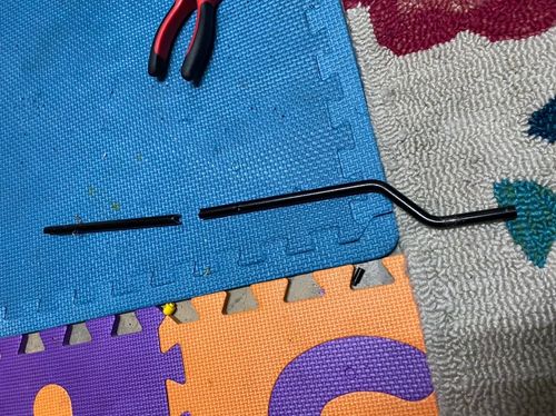

Hi all,
this is a toy car’s rod which connects with the steering to the wheels. It broke down and I have no idea how to get it fixed. Not sure if I should use epoxy or if there is some other way to have a strong bond to connect this broken part
thanks,
redracer01

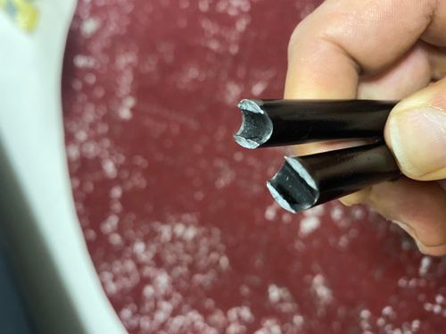

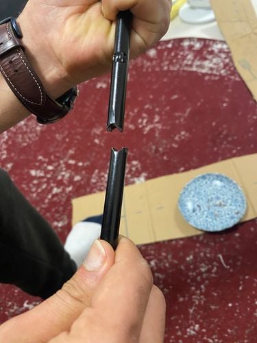

Given there is not a lot of metal left once the hole was drilled there is not a simple way to weld it together that would hold. Sleeve would need to be drilled to match the hole and if welding I would silver solder the sleeve on as capillary action would give the largest surface area to work with and TIG welding would be my 2nd choice given the size your working with.
Pinning the sleeve on lets you use a dissimilar metal tube and if the pieces of rod fitted together nicely ( looks from the photo that they have deformed slightly ) I would epoxy the halves together as every little bit helps.

Thanks you very much for ur valuable input. Just to add more details please see pictures attached. (It’s not a straight rod)
If I try to fix it with a pipe then it won’t pass through the plastic hole (please see pic with white plastic part ) and that’s the exact point where it got broken as well.
