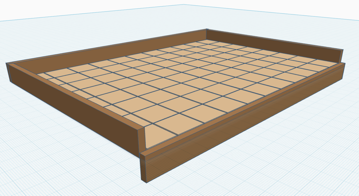

From your description, it sounds like the paved section meets another level surface, so you’ll need a neat way of keeping the pavers in place without creating a trip hazard. A common solution is to dig a shallow trench along that 2.4m edge and install a treated pine border so that it sits buried in the ground and is flush with the surface of both the pavers and the adjoining area. This way, it acts as a retaining edge to keep the pavers secure, while still giving you a smooth transition between spaces.
I've created the below rendering to illustrate.
