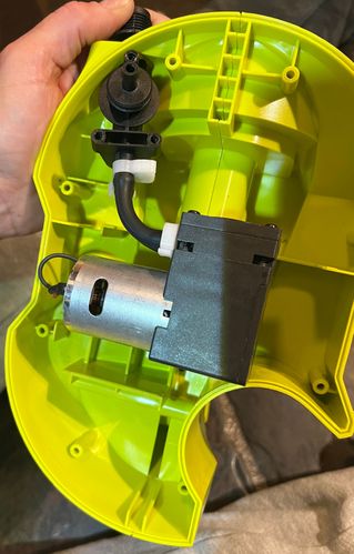

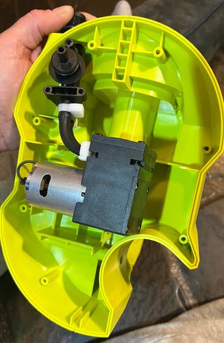

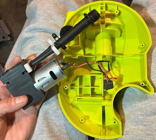

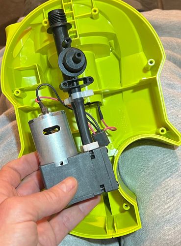

Now I can’t get the pump back into place to test if it has worked?
I attempted this  because I had eliminated all other potential  issues so it was a Hail Mary because I am some distance from Bunnings and was trying to avoid the trip.

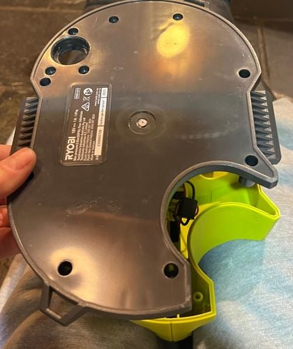

In order to have the nozzle in the right spot for the Oring  to be secured when the base plate goes back on I cannnot seat it back properly.
it feels back to front?!

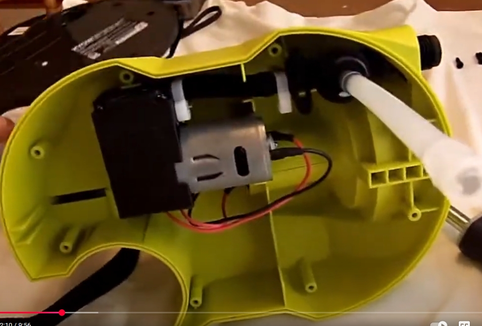

The video you linked to actually has an image of the position of the motor before it was totally disassembled. I've placed an image below to give you an idea of how the motor is positioned. Your last photo is very close to the actual position except the motor should be on the right-hand side. Please have a look at the image below and let us know if you have any other questions about its position. Some parts of the pipe assembly might need to be repositioned as they are facing in the other direction.
