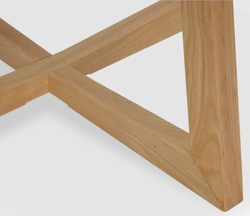

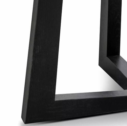

I've been looking at buying a dining table with Ash Wood legs. However, the one with Matte black finished legs is out of stock and not coming back in stock anytime soon. Only the "Natural Ash Wood" version is in stock.
Is it possible to repaint the legs in the matte black paint as per the pictures on the site? Will it retain the grain lines?

I've had great success using Rust-Oleum 340g Black Matt 2X Ultra Cover Paint+Prime Spray Paint over timber. After enough light coats to cover the timber, the grain was still noticeable. However, if you lay on thick coats, you'll soon conceal the timber grain significantly. The other option is to use Feastwatson Black Japan Stain. Even if you apply thicker coats, the timber grain will still be quite noticeable through the stain.
The one issue you might run into is if this table has already been varnished. Do you know if it has a coating on it already? If it does, then it would need to be sanded off in order to let the grain show through these products. I would not advise you to apply stain over the varnish as it needs to penetrate into the timber, which the varnish will prevent. For the spray paint, you could apply it over the varnish, but I wouldn't expect you to see the timber grain through a varnish and a paint.

I think it might be a difference in the terms we are using, and that I've said it's a smooth texture already that has confused the discussion. It's smooth in the sense that the timber could be a lot rougher, but I understand what you mean. That rough texture is part of the grain, and it's also the pores of the wood. With paint, you'll lose the colour difference in the grain, but you won't necessarily lose the grain's rough texture. I've added some photos below of a chair I've spray painted with three coats. You'll see that rough texture is still present. You can also see the grain layering. On areas I applied too thick of a coat, the paint filled up the grain and created a smooth surface devoid of any rough texture or appearance of grain.
If you're looking to keep that rough texture, just keep your coats of paint nice and thin and don't flood out areas.
