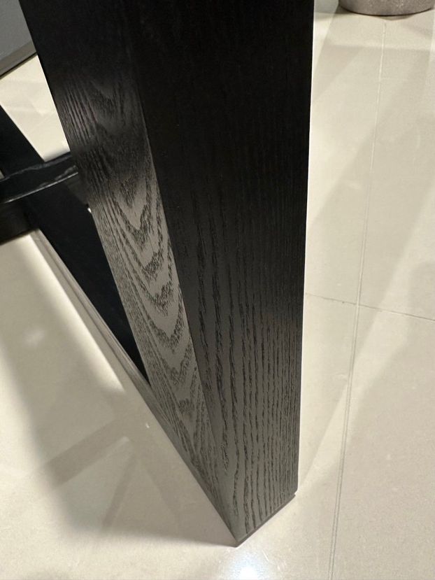

Thanks @MitchellMc & @EricL. The painting was a success!
I did a light sand and then used the Rust-Oleum Black Matt spray paint.
Re: Can you paint Ash Wood legs black?
Hello @hc14
Thank you very much for the update on your Ash Wood timber leg project. It looks fantastic and the grain really stands out.
