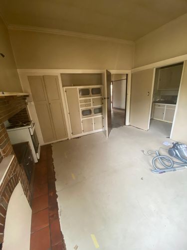

Not sure how to go about making the space in the kitchen a clean slate! We were thinking the easiest and cheapest thing would be to just cover it up. Has anyone else had an old school kitchen like this and done something useful with it? The kitchen is quite small to so we just want to make it modern and usable.
how would we go about covering it up?

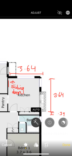

edit: uploaded a new photo. The flooring is now removed (asbestos) and we have great floorboards. we have also removed the cupboards so there is some extra room there.
I realised the plan doesn’t have the door leading to the porch next to the pantry. We plan on having the fridge and shelves in the pantry.

I believe you are correct that the easiest way to cover it up would be to frame up a thin stud framework and plaster over the bricked area. You should find these step-by-step guides useful: How To Build A Stud Wall and How To Plasterboard A Stud Wall.

I totally agree with @MitchellMc 's recommendation to build a wall in front of the old brick cooker. Mind you I suggest having a look at google what model you have as some of those steel wood fire burning stoves sometimes fetch up $1,000 dollars and up! I suggest the following :
- Remove the doors and panels in the old pantry set, we will add that space to your kitchen as seen in my drawing.
- Remove the cornices and finishing panels near the pantry and where your old sink is to give your room a more uniform finished look.
- I suspect you have an old post war home or an older model as the ceiling height looks like it is at 3 meters.
- Your old sink spot now does double duty as fridge space and walk in pantry with sliding barn door. I will leave the placement of the shelves to you as you can customize it to your cooking appliances ( kitchen aid, waffle maker etc. ).
- Once you build your extra wall it has to go all the way in to your old pantry to give the kitchen a straight line and we wont have to modify any of the cabinets.
- The wall will not take up that much space. But before you seal it make sure that the chimney and all other flues going through your ceiling has been decommissioned and sealed. Last thing we want is to have critters taking up residence behind your wall.
This is what it could be, I am aware that there are other ways to re-design this kitchen but time and money are always a factor in these things. But you are in the planning stage at the moment, look around at other kitchen designs and incorporate those things that you want into the current design and come back to me and I will modify the drawing for you. Please post any questions or queries you might have we will more than happy answer them.
Cheers,
Red
