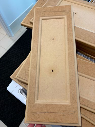

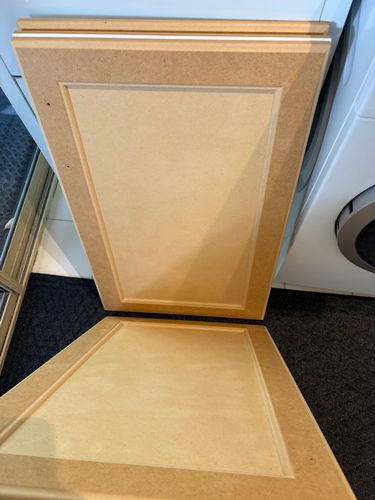

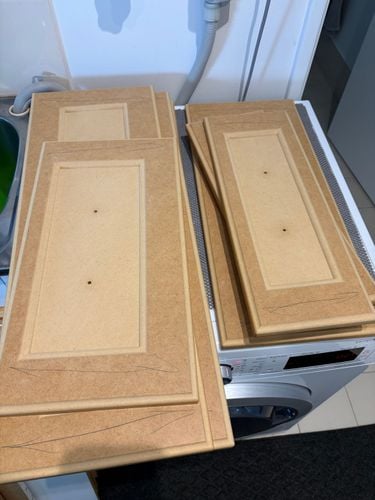

I have just removed the drawer-fronts and door-fronts from our kitchen cabinets. They were previously vinyl-wrapped, but I have removed the vinyl using a hair dryer.
They popped off very easily and the MDF is in perfect condition. Although they felt slightly tacky when warm (immediately after I had removed the vinyl), once cool, any traces of glue feel smooth to the touch and are pretty invisible to the eye except for slight variations in sheen when viewed under light from the side.
What is the process from here? Do I need to remove absolutely all traces of the glue? Or is a very thin film that I can’t feel (and can hardly see) ok if I use a good enough primer?
What products do I use from here on? I assume at least a primer and then some type of hard-wearing paint? I am hoping for a Satin finish. Do I need to sand before and/or between coats? And if so, what grit at each stage?
Should I invest in a power sander? If so, what type? Or is hand-sanding sufficient?

I suggest investing in a detail sander such as the Ryobi 18V ONE+ Palm Sander Kit or similar. It would be best to sand the surface down so that you get a nice flat consistent finish. At the moment it may appear that the panel surface is flat but when painted over you'll see that the surface is actually quite bumpy and imperfect. I suggest using Dulux 1Step Prep Primer, Sealer & Undercoat 4L for your primer and the Dulux 4L Aquanamel Semi Gloss White Enamel Paint - 4L for the top coat tinted to your preferred colour. No extra coating is necessary as the Aquanamel is designed for furniture and daily use.
