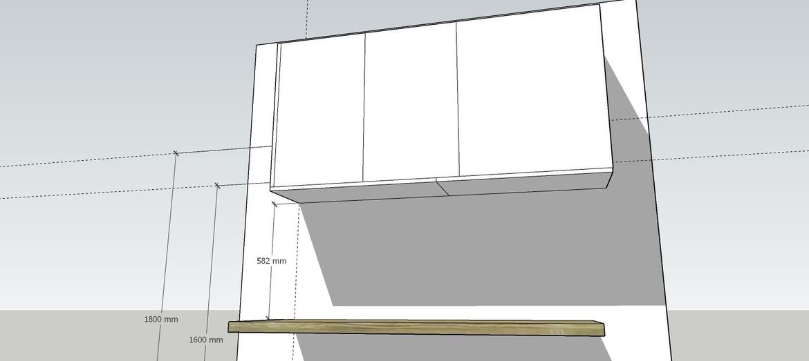

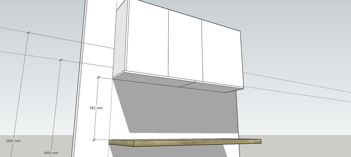

As you can see from my render, the typical female height is 1600mm and thus the line of sight is above the bottom of the wall cabinet which is around 1500mm. The males will not even see this as the typical male height is around 1800mm. Most flat pack cabinet makers make their carcass or cabinet boxes from matt or satin finish melamine. This is purely for economic reasons as making it out of the door material makes the cabinetry even more expensive. Now I know the bottom finish of the cabinets is not to your liking, but I doubt your family, friends and guests will make it their first priority at looking at the bottom of your wall cabinet! But the final choice is yours, stay safe and good luck!
