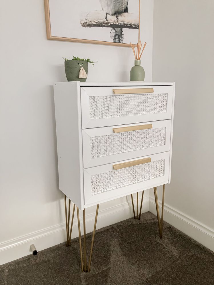

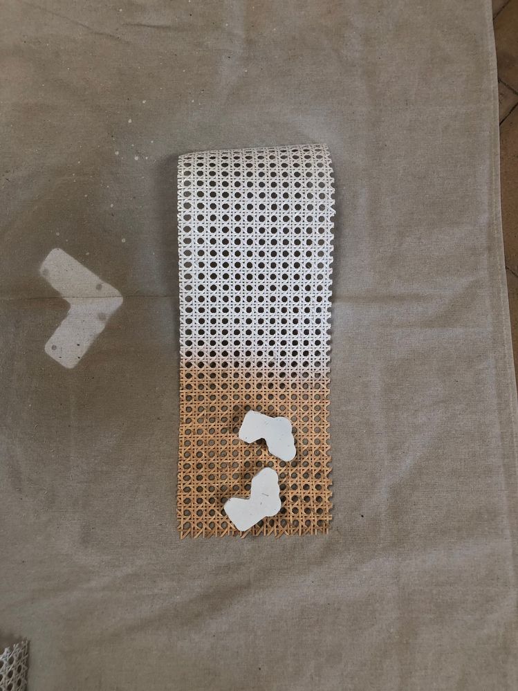

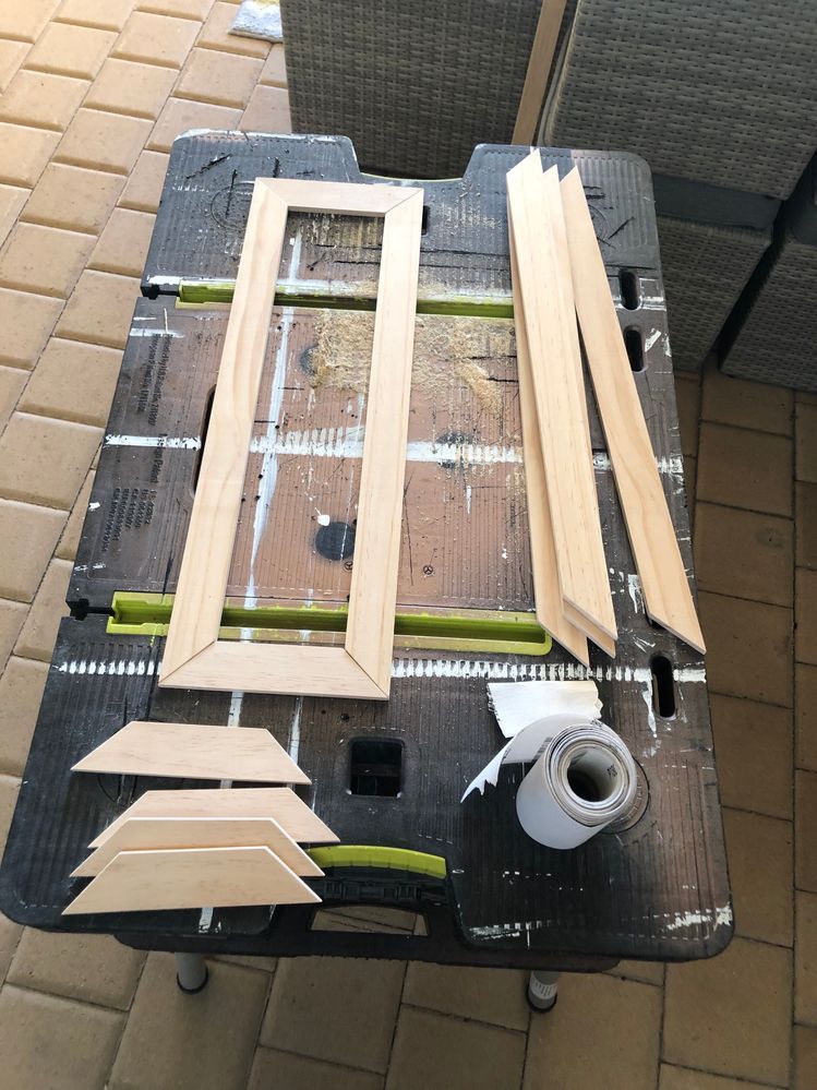

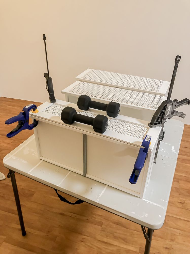

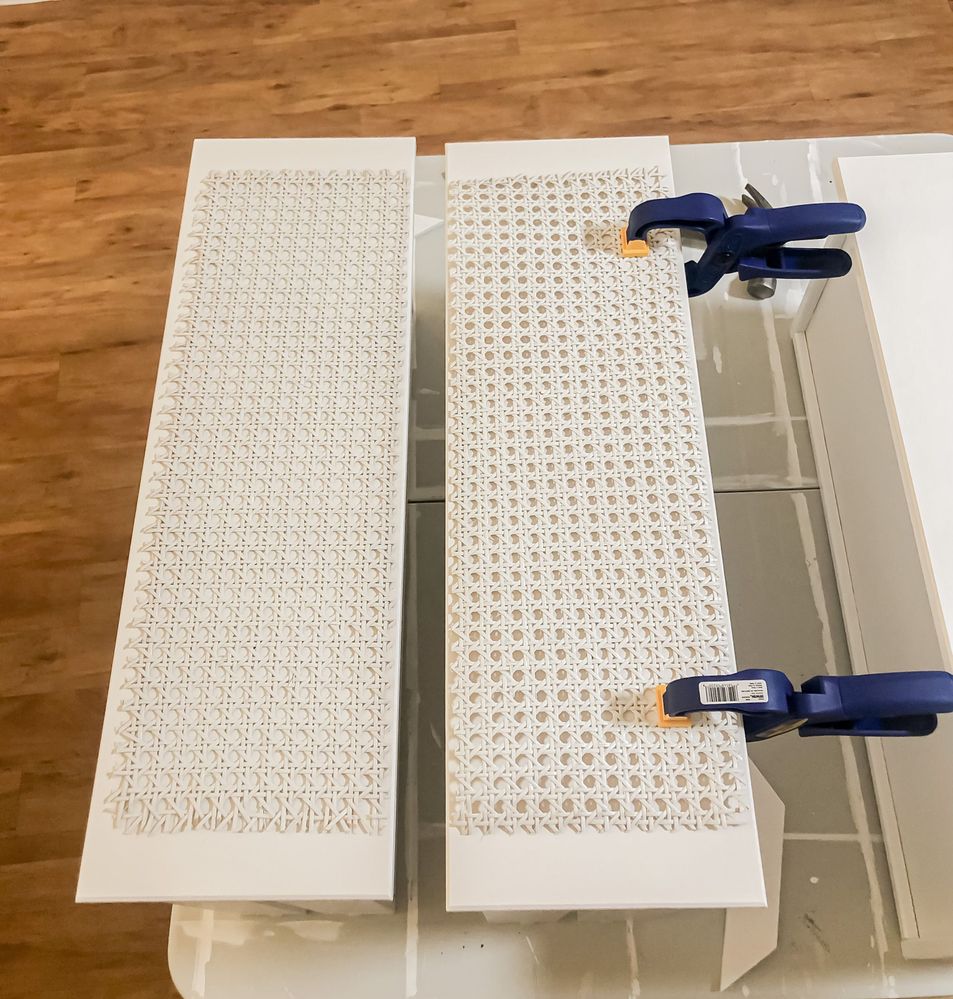

I absolutely adore the whole rattan furniture vibe, but couldn't find *exactly* what I wanted in the shops to fit my measly budget. I bought a new, basic untreated pine set of drawers and decided to work my magic! First, I modified the base so that the plinth was removed, and primed and painted the entire unit, before putting it together. I found some raw rattan rolls in one of my local stores for $10 each. The rattan was cut to size, spray painted white and glued onto the fronts of the drawers. I bought some hairpin legs from Bunnings and sprayed them gold (Squirts Gold spray paint is the best shade of gold if anyone is interested - I have tried them all!) as they only had the black ones when I bought them! I bought some mouldings which were also primed and painted, mitred and glued them to the perimeters of the drawers, to hide the rattan edge and to improve the aesthetics. I ran around the house looking for something heavy to use whilst the mouldings were drying, because at this stage as I ran out of clamps. Guess what I used?! Once everything was dry, I caulked, sanded and re-painted the perimeters of the drawers. I then attached the legs and new handles I'd bought online and voilà, the transformation was complete!

As for your question about guessing what you used as weights, I wonder how many of our members know what weights you used to weigh down the rattan. 😉

I too believe that weights should not remain in the gym! A very clever tool to make such a stunning coastal meets traditional piece. Thank you for taking us through your process and for the recommendation on products. Really well done.
